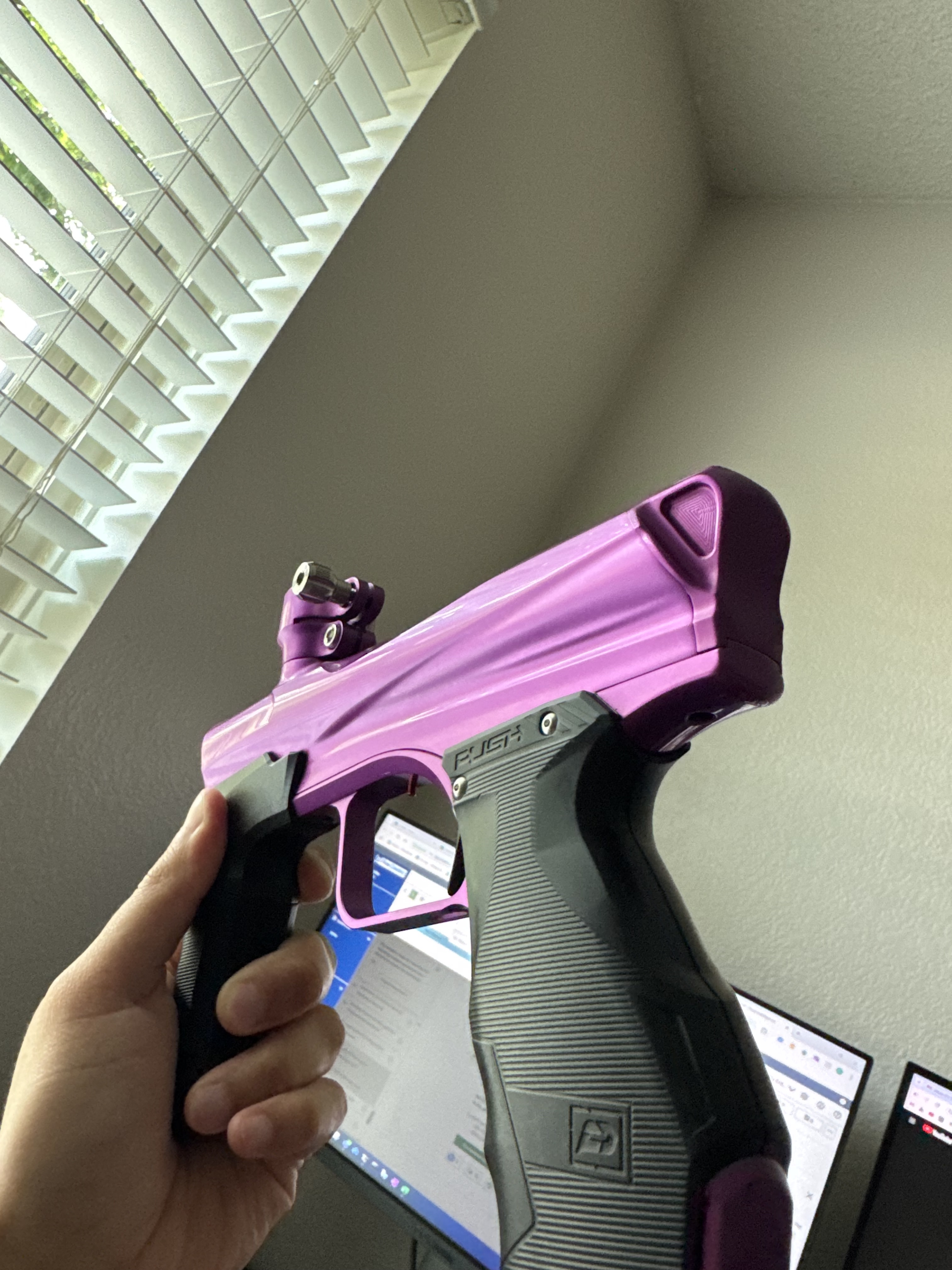

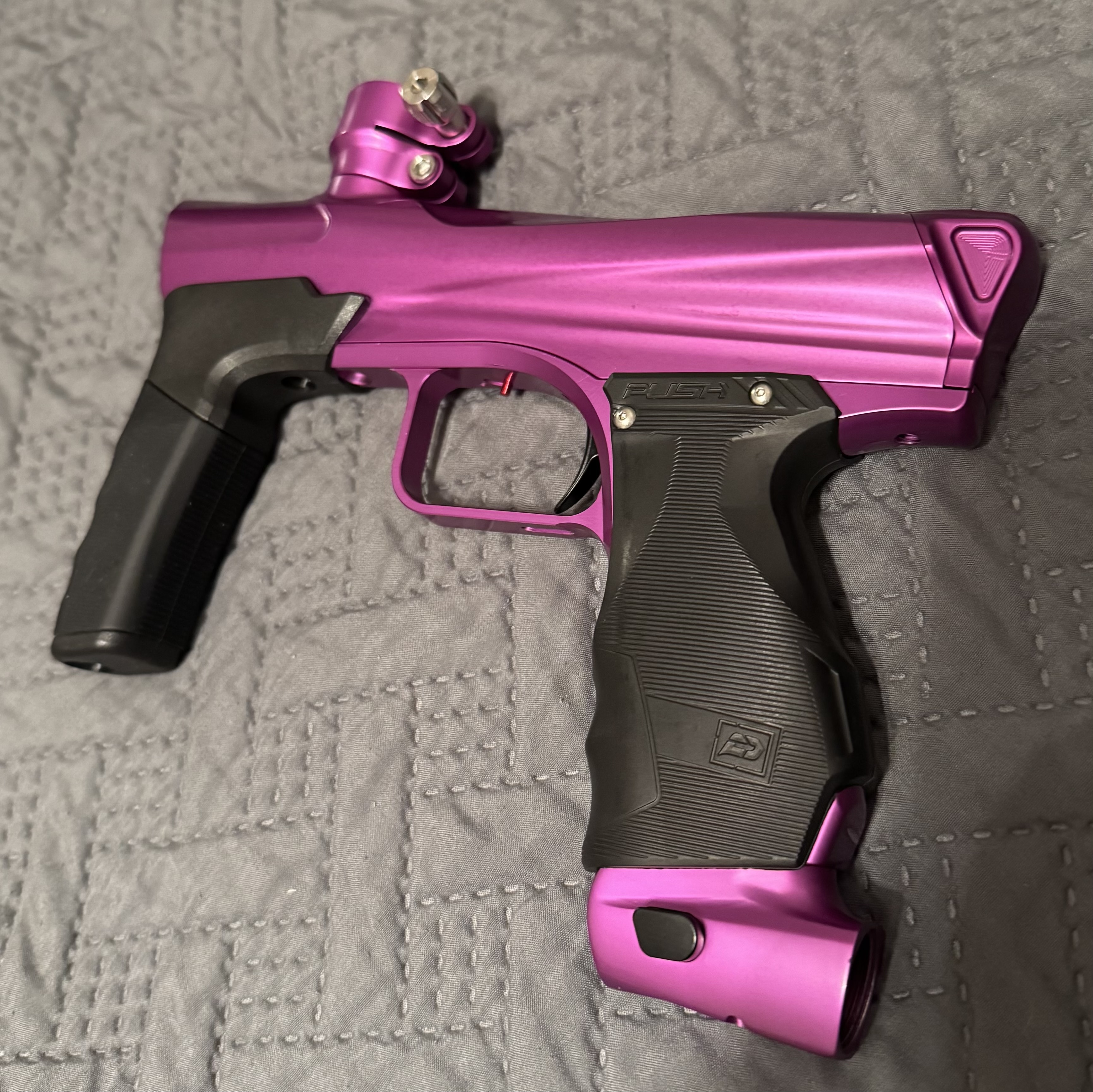

Hello everyone! Here is my review of the new Push Propel after playing a couple weekends and doing lots of backyard shooting.
Ergonomics
Apparently these are just rebranded Flowtech R-Mac's (with new grips and case). I saw some videos and pictures and thought the ergos looked really nice. Can confirm after holding and playing with the marker a couple weekends it does indeed feel amazing in the hands. The front grip is a bit stretched out and it's got a nice grippy texture to it. Marker also felt really balanced for me with my JT Triad and 68/4500 tank. I also really like the grips on the handle wrapping around. Getting them off is a bit of pain (have to remove the ASA) but overall, the ergonomics is one of the strong points of the Propel, in my opinion.
