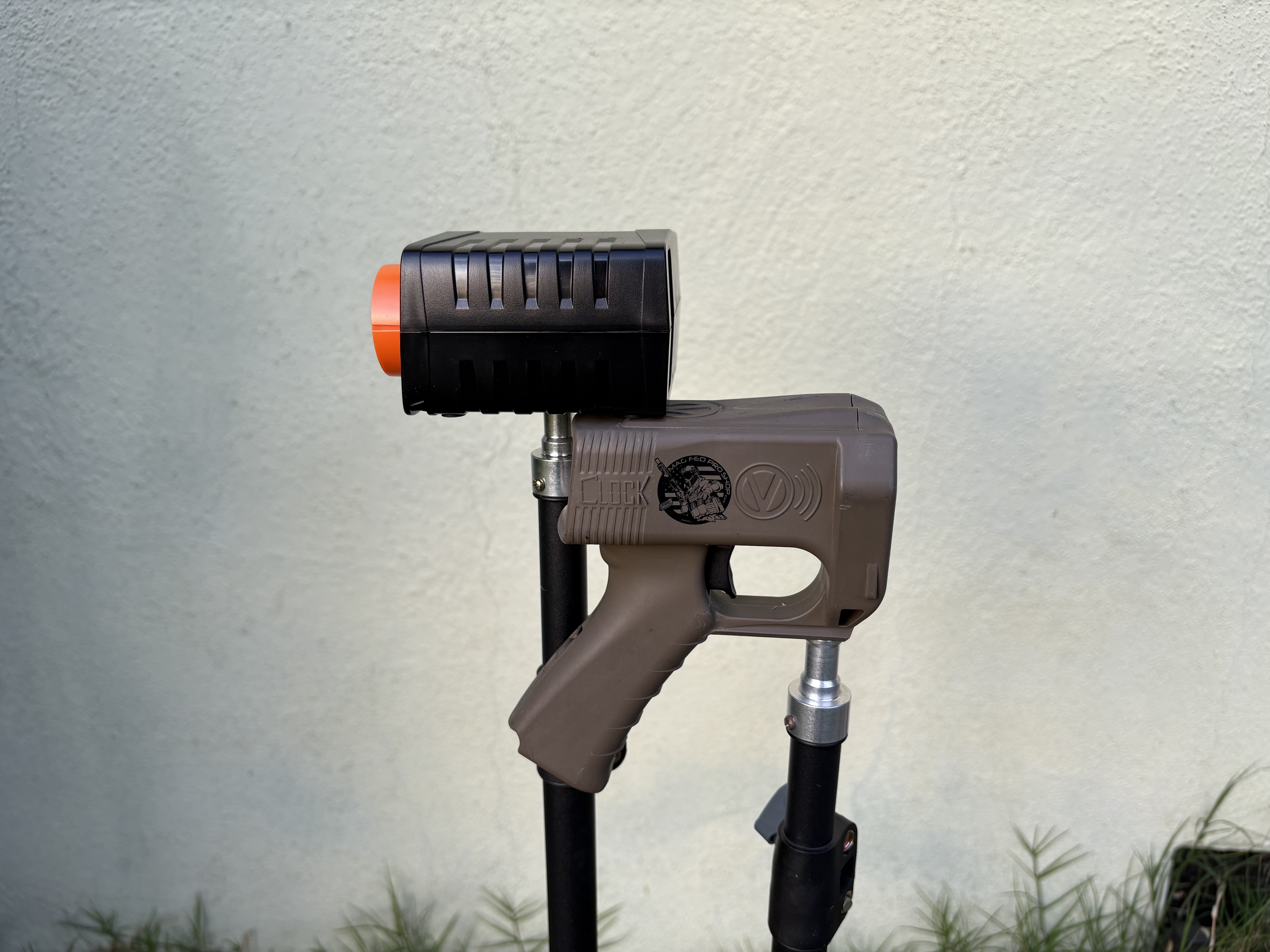

    Greetings McB community,
    Please be friendly, I've started to look at the world of AirSoft. My paintball markers have been giving me the stink eye since I purchased my first AirSoft AEG. I promised I'll take my paintball markers to the next big game in the immediate future, even better would be a trip to the Skirmish ION big game.
    I came across this AirSoft Chronograph. It was pleasantly priced between $50-$55 at various online sites. The specs said "COMPATIBILITY: 4.5MM, 6MM, 8MM, AND 18MM BBS" and while I couldn't mental math the measurement conversion, the computer says 18mm converts to 0.70 caliber - which is perfect for paintball.
    Pros:
    + It does work for paintball. The measurements were 2-3FPS higher than a Virtue Clock III when stacked on top of each other.
    + I was able to get consistent measurement in shady and direct sunlight conditions. This chronograph has two sensors, similar to the Chrony, Caldwell, ProChronos. I've used the Chrony and Caldwell types, and never been happy with the performance in various light conditions.
    + Small package when compared to Caldwell and ProChronos.
    Cons:
    - Holding barrel position does take some patience. I admit that I had impatience and blasted the insides of the AceTech, especially when trying to rapid fire for BPS readings.
    - BPS (ball per second (I wasn't able to get a decent comparison to the Virtue Clock III). The readings were not consistent with paintballs, yet did quite well with AirSoft. One thought is have a guide to keep the paintball barrel inline with the chronograph sensors.
    Summary: Works great for AirSoft. Does the bare minimum for paintball. I think spending an additional $ for Radar-type chronograph is best for paintball, if used often. I haven't tried different color paintball shells.

        I got one recently and it seems to do just fine. It’s kinda hard to shoot through such a small hole especially when aiming for a small backstop. What settings do you have the ammo section set at? I have the weight on 3 grams and caliber to 18. It gets good readings with my phantom but when I shoot my kp2 the readings are ridiculously high and low
        • mooman978
          mooman978 commented
          I figured out why the readings were off I was shooting the inside of the walls. Its best to put the barrel a little bit past the opening to get good readings
