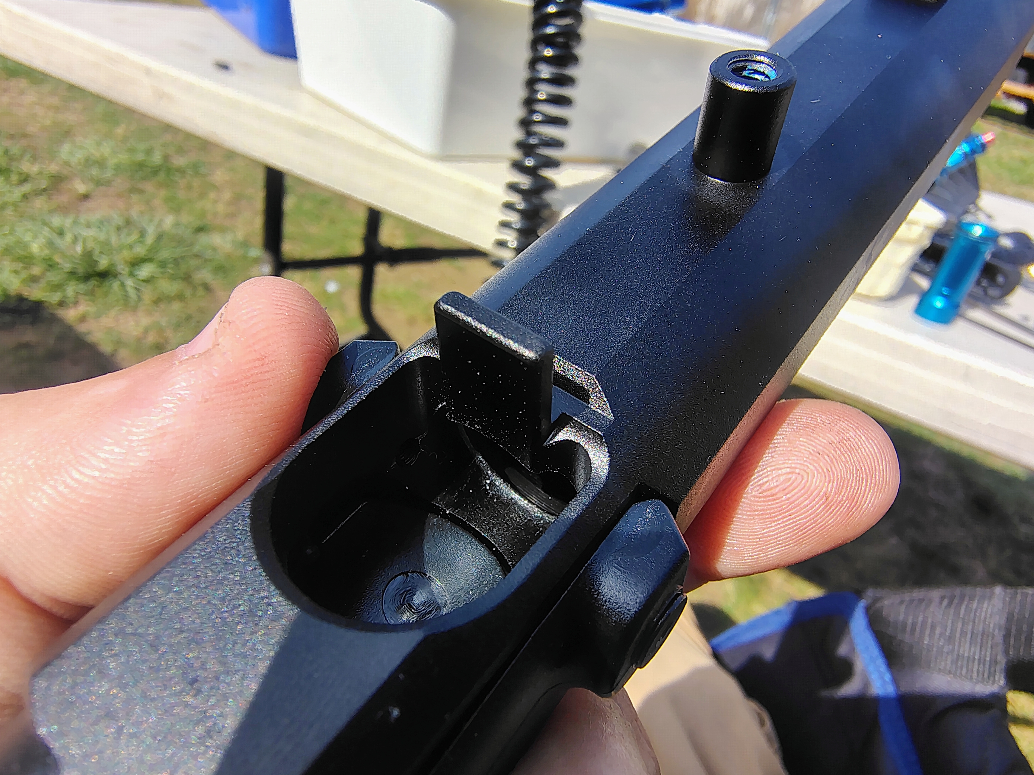

          I tried to install one of these for Super Nova today but I think his body has a manufacturing error. There's a lip just to the back of the breach, you can see the sunlight on it in the photo, but it is pinching the bolt and the bolt won't move. Can someone else pull their bolt out of this MCs kit and see if there's a lip or if it just drops off to the larger section of the body tube? The stock body does not have this, I compared with that.

            I'll see if I can get mine out, but I would contact MCS.
          • 6175
          I contacted mcs and they are sending a replacement. They want this body back to figure out what happened
