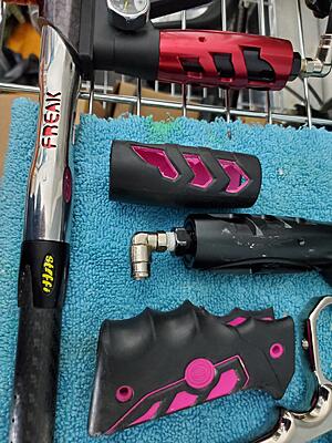

                I have a pink set of grips, but the regulator has the windows cut out. You can have them for the cost of shipping if you want them

                  I have a model I've been working on for a reg cover. I printed one and it lasted for about 6 months till the cutouts started breaking. (too thin!) It's been on my mech Ion. I plan on beefing up the model and making it more girthy while still keeping the grip design. I won't be doing any revisions till I'm on full on holiday PTO mode in a few weeks. I've got a few design changes but nothing solid till I get all up in there with the calipers. So with that being said, if you don't get a good solution, I may have something for you into the new year.
