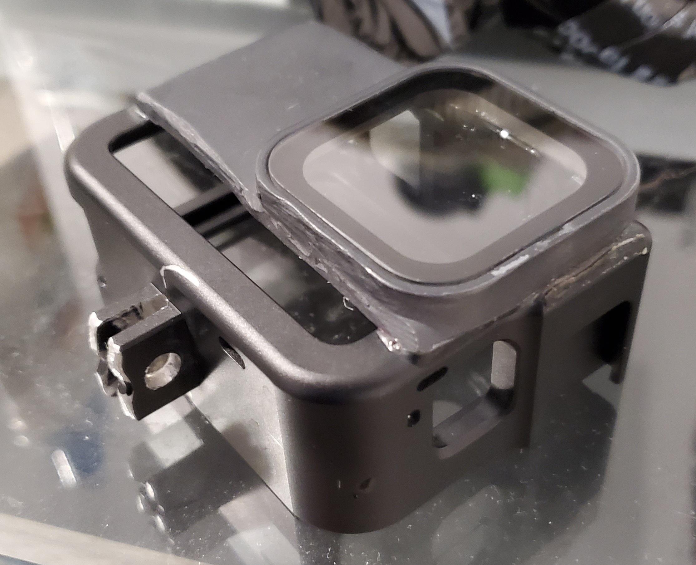

        A camera with good anti-shake functionality like a GoPro 7 (or above) or DJI Action 2 on your mask is the more important of the two. A lot people run these things unprotected on their masks but every other month there's someone on the Paintball Reddit who shows their new GoPro 11 that's been wrecked by a paintball hit, so I've always run some kind of case. Overheating becomes a problem with the plastic watertight cases but drilling ventilation holes can help. The only way I was able to get my GoPro 8 to stop overheating on sunny days was to go to an aluminum cage that acts like a big heat sink and glue the plastic lens-protecting front to it.

        What aluminum cage and plastic lense protecting front did you use to make yours, I got a go pro hero 11 for free and figure I might as well dump some money in protecting it since I didn't pay for it
        I don't remember exactly but they certainly weren't name brand. I think I just searched for "GoPro 8 case aluminum" on eBay and sorted by cheapest. Like a lot of off-brand camera accessories you'll often find the same product being sold with minor (or no) variations being sold under several different names.
        Also, I want to say that GoPro hasn't changed their form factor in a while, so cases made for the 9 will fit the 9, 10, or 11. Not 100% sure of that, though.
