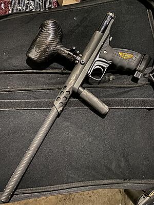

            Got to sand the feedneck a lil and lid mod it but the CF Winchester looks pretty cool. Probably going to put a mat clear on it.
            • Brokeass_baller
              Pick it up!
              • 1129
              • Ohio
              I say put a Nitro Duck on it and get a drop forward, like a man.
