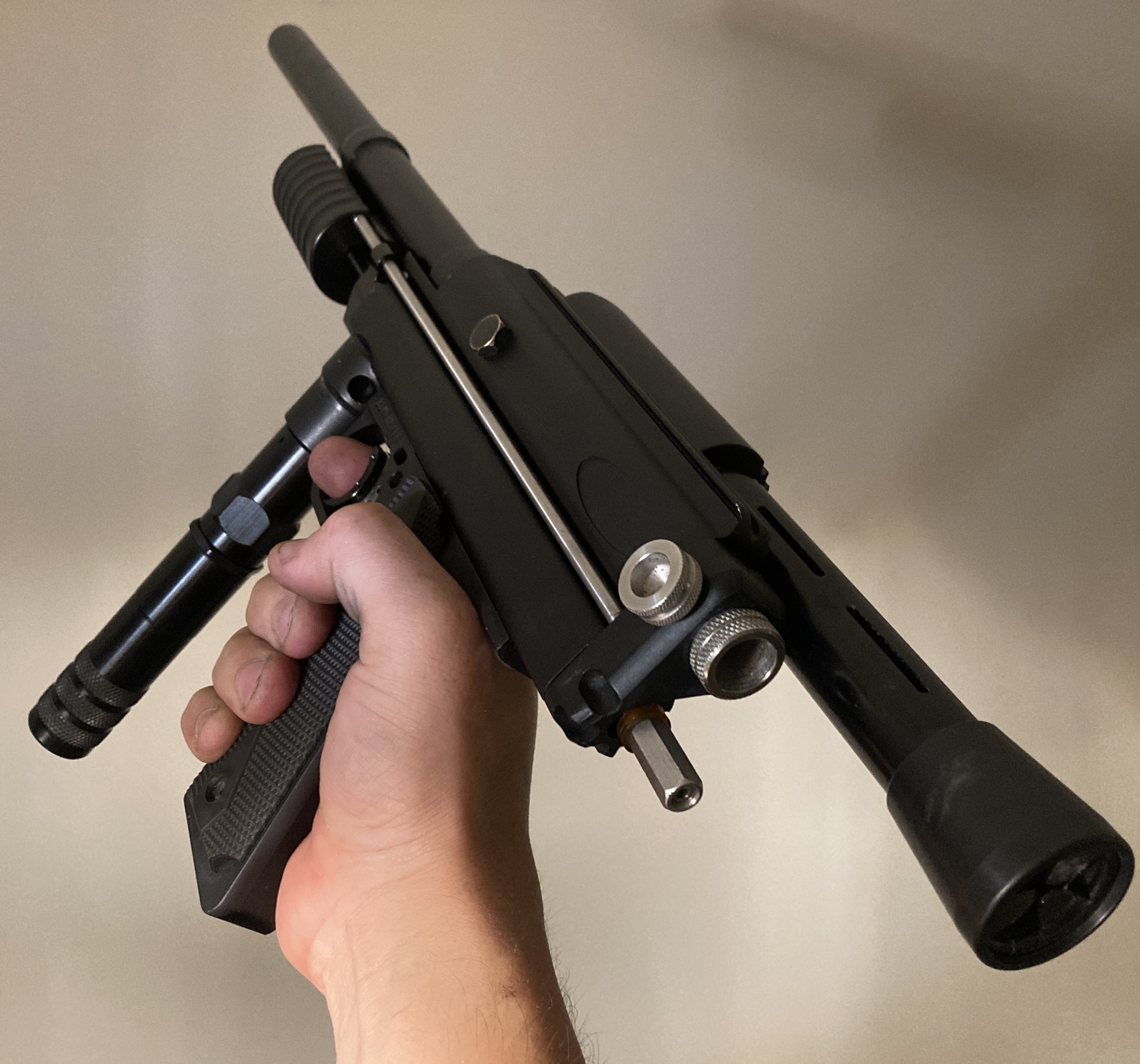

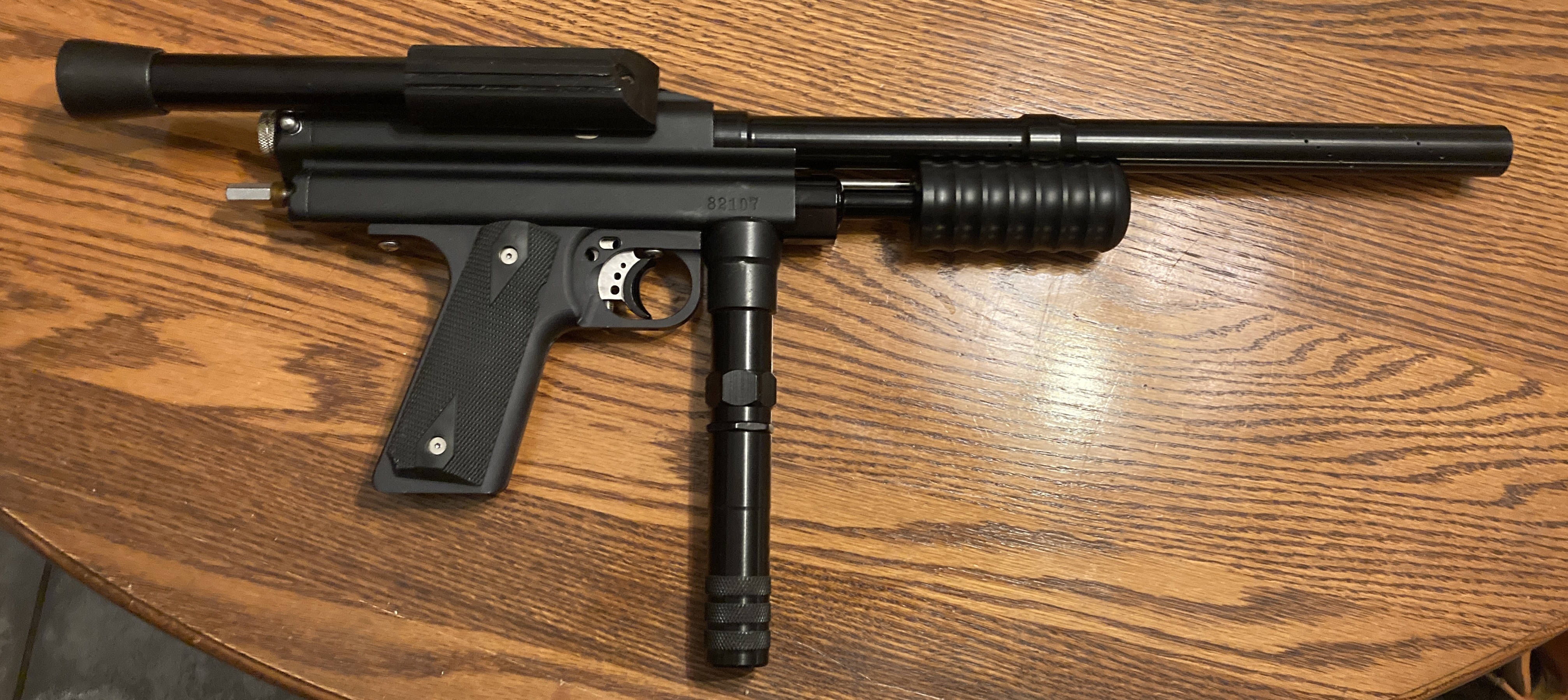

      if youre looking to build a stock class sniper, its easy to pull the neck and drill and tap a RF body for a cci feed.

      I've designed and sell a similar feed for new Sterlings, one that slides onto the T-rail.
      On older guns, rounding the top tube to a 1/2" radius to install a Phantom feed is often trivial for a machinist. A lot of older Nelson pumps can have the feedneck trimmed off, too.
      There's something better about "laying low".
