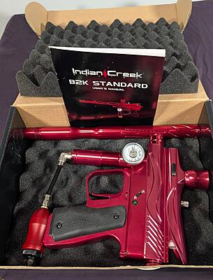

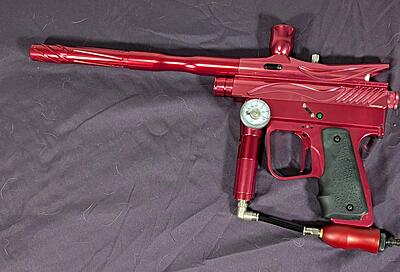

    So, I played a lot back in the day. Bought this, never used it, forgot about it, found it, and am curious if it still holds its own. GF was asking on reddit and seems there some nostalgia for it at least. They sent me here.

        redsquirrel Thanks for the summoning! 😂
        Op, they are not only viable, but they are honestly my preferred electro shooter. If your still running the stock board it's capped at like 22 BPS, so wayyyyy faster then today's 10.5, but you'll actually have to put the work in since there is no ramping.
        It WILL need work at this age. At a minimum replace all the seals, be sure to use 90 durometer for the manifold in the 2k3/4s that use the Humphrey noids. ICD regs are also not great. I'd probably swap out the HPR at a minimum.
        Be sure to check out my build thread here for extra tip and tricks:
        https://www.mcarterbrown.com/forum/p...r-2000-rebuild
        lhamilton1807 also just recently rebuilt a vision 2k4, there is some good into in there as well.
        https://www.mcarterbrown.com/forum/p...g-my-first-b2k
        ​​​​​​​ Anything not covered between the two build threads, feel free to ask! These things were really built to last and hold up great if you sink enough love into them.

          Seals were replaced about 3 years ago, never put air through it since. Probably dried by now right?
          • Myrkul
            Myrkul commented
            Probably. Also: do NOT use oil in these, it will swell the delrin bolt. Be sure to use lube only, I prefer suberlube multipurpose grease.

          Nice B2K! Did you get that from ansgear when they were having their super sale?
          I have mine packed up for SuperGame and am excited to let her run. Aside from the eyes and hpr, your rebuild will be identical to mine. Vapor triggers may not be available anymore though - you’ll have to check their website.

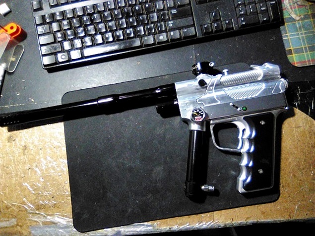

                  I have several tucked away but for Ooooooo factor I always brought out Gregs Frostbite cuz it's my ICD unicorn....
                  • Myrkul
                    Myrkul commented
                    Ohhhh you don't see many GS Frostbites! With Zenitram bits to boot! Beautiful marker!
                    oh man this is peak 2003, I love the Zeni frames
