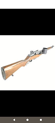

            I think you all are right on it being an engler. Found this picture and it looks exactly like the one I saw

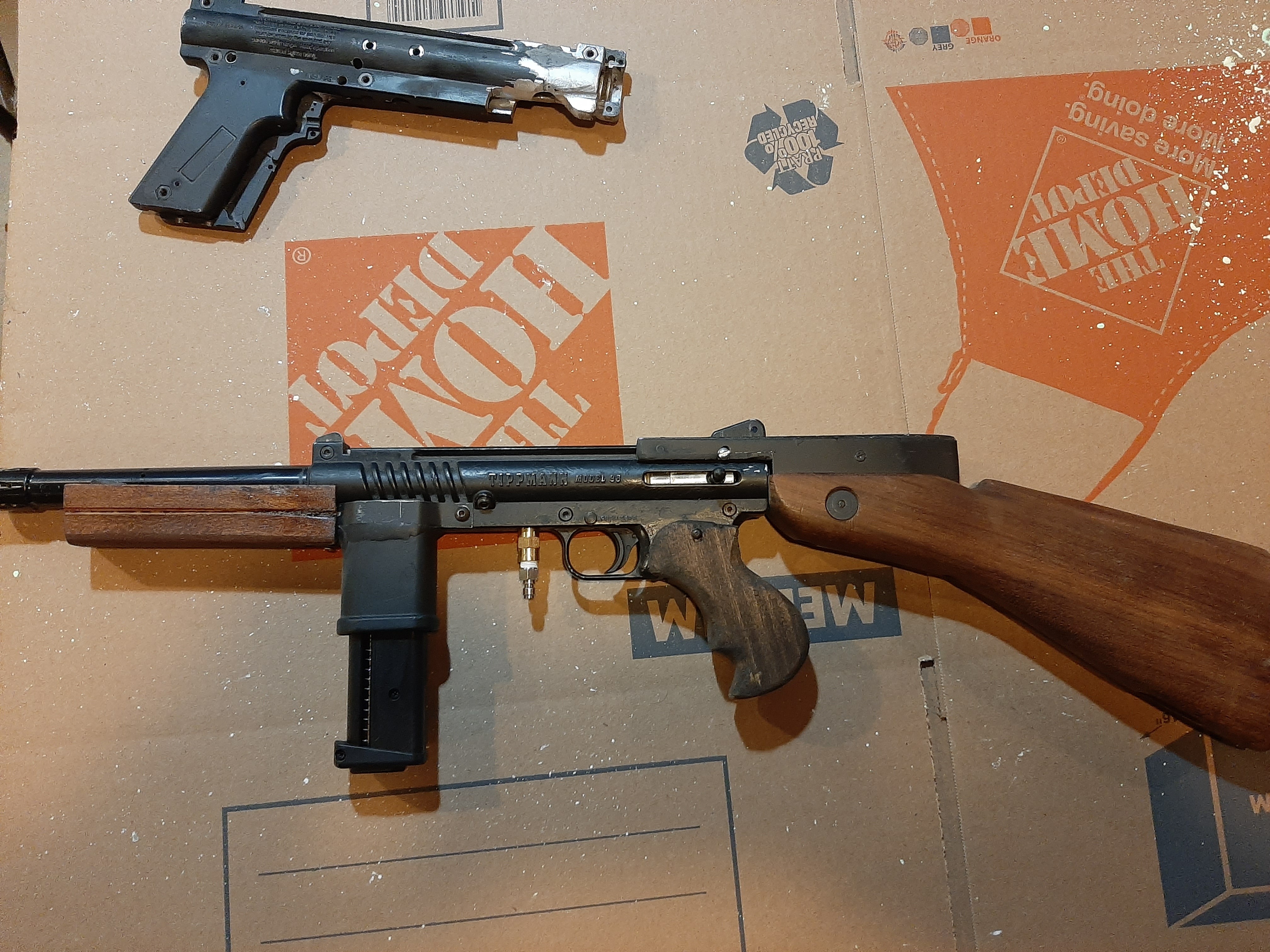

                    I haven't made an exact M1 Garand, but I did make these. Unlike the Engler models, these are all mag fed. Top to Bottom: M1A1 Thompson, M1 Carbine, M1, M14. Not perfect specimens, but give the correct feel of what they represent. Still working on an M1 with interior spring mag, so that it truly looks like an M1

                      What are these mag adapters you're using? I've looked into doing a magfed conversion on a pro carbine but everything I've seen just puts a magwell where the current feedneck is, never below the marker like this.

                      I custom cut and fill the original marker bodies. See the first picture. The magwells are mostly commercially made for Tippmann, RAP4 or DYE. I modify the magwells to attach to the modified bodies or the rifle stock.

                    COB how did you do the trigger system for the tippmann pro-lite M1? I’m working on converting a couple tippmann 68 carbines to garand stocks and trying to research/ figure out how to rig a trigger in there without spending 500hrs lol
                    if you have some pictures of the trigger mechanics I’d be most indebted!

                      Sorry for the delay. That particular trigger is a custom mod of the original metal trigger. I cut the original short, keeping all the original sear and pin locations intact. I cut and modified the original trigger frame to fit in the stock. Again, allowing the use of the original pin, spring and sear locations to be used. I then cut an extension from a flat steel bar. Shaped and smoothed the extension. Welded the extension to the cut original, Ground the excess weld, and Bob's your Uncle, a new trigger offset for the carbine stock.
                      When possible, I prefer to modify or create a new trigger using the original location on the base marker. Sometimes this is not possible, because the marker body or air line will interfere with the natural grip location on the wood stock. This will require the marker to be set forward in the wood stock, putting the trigger location too far out of reach. Unless you are ET, then your fingers may reach. I those cases, I pin a trigger in the stock where it is needed and link it to the original trigger on the marker.
