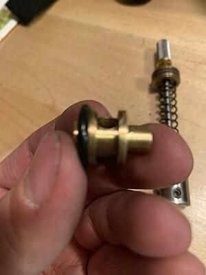

    Wgp Valve
    This is the first time I've rebuilt an autococker wgp 2k from scratch. I don't know if this valve is worn, which would explain the leaks?
    • 2835
    Looks like an older pre2k valve. Can't tell if worn, but have you changed out the o-ring already?

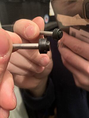

      Try to take a clearer pic of the valve and face. It probably just needs fresh rings and maybe a new cup seal.

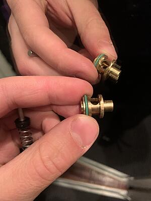

        WGP High flow vlave.
        012 oring size.

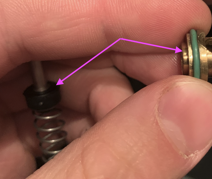

        Check the lip for dings or damage. But most likely the issue is with the cup seal on the stem.

            The valve doesn’t appear to have any unusual damage. Like the others have said, try a new cup seal.
            Also make sure the marker is cocked before airing it up.

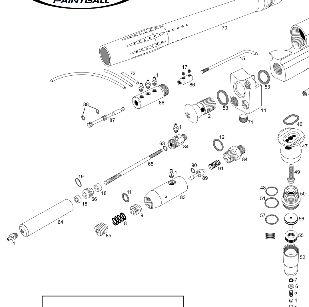

                Hi, does anyone have a plan to lpr orknow the order of the pieces;
                • latches109
                  Always Sciencing
                  • 2075
                  open it up, don't be scared its easy. 011 70D oring, 009, 012. I like HBNR but also HBR is fine.
