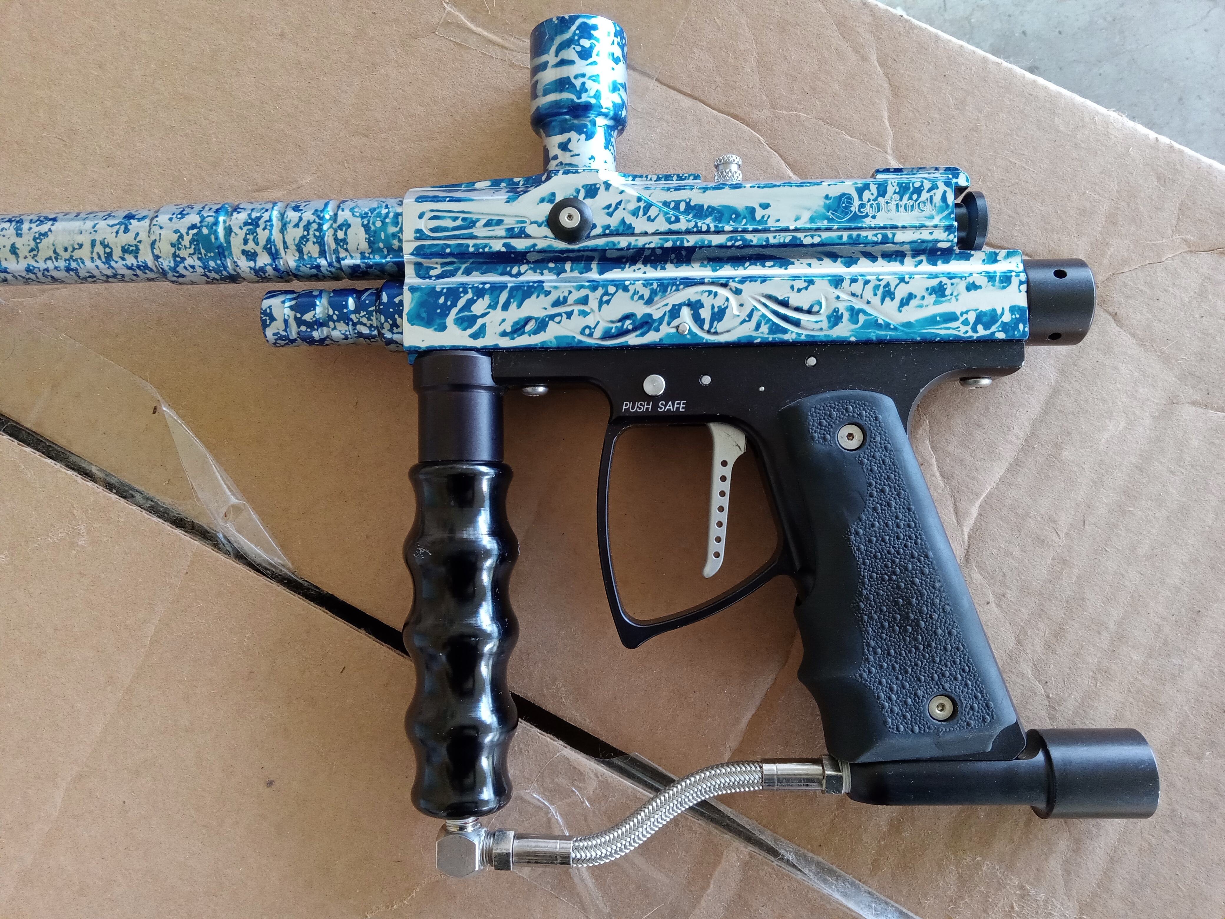

    Just got a sentinel
    Ok guys just picked this up, what do I need to know about them other then they can be finicky to get to velocity, what feednecks do they take and what's up with those bb detents they kinda make me wonder if they will even hold today's small ass paint
    • 4511
    1 - I think they take Angel threaded feednecks
    2 - If you struggle getting up to velocity you may want to consider grabbing one of the valves that flyweightnate made. I didn't have any trouble getting mine up to field velocity with a higher output HPA tank.
    3 - The dual detents should be pretty good with holding paint, I don't recall having any rollouts with mine. If you find yourself getting rollouts you may need to mode one of the detents to accept a longer nubbin-style detent.
    Lovely gun, good luck!

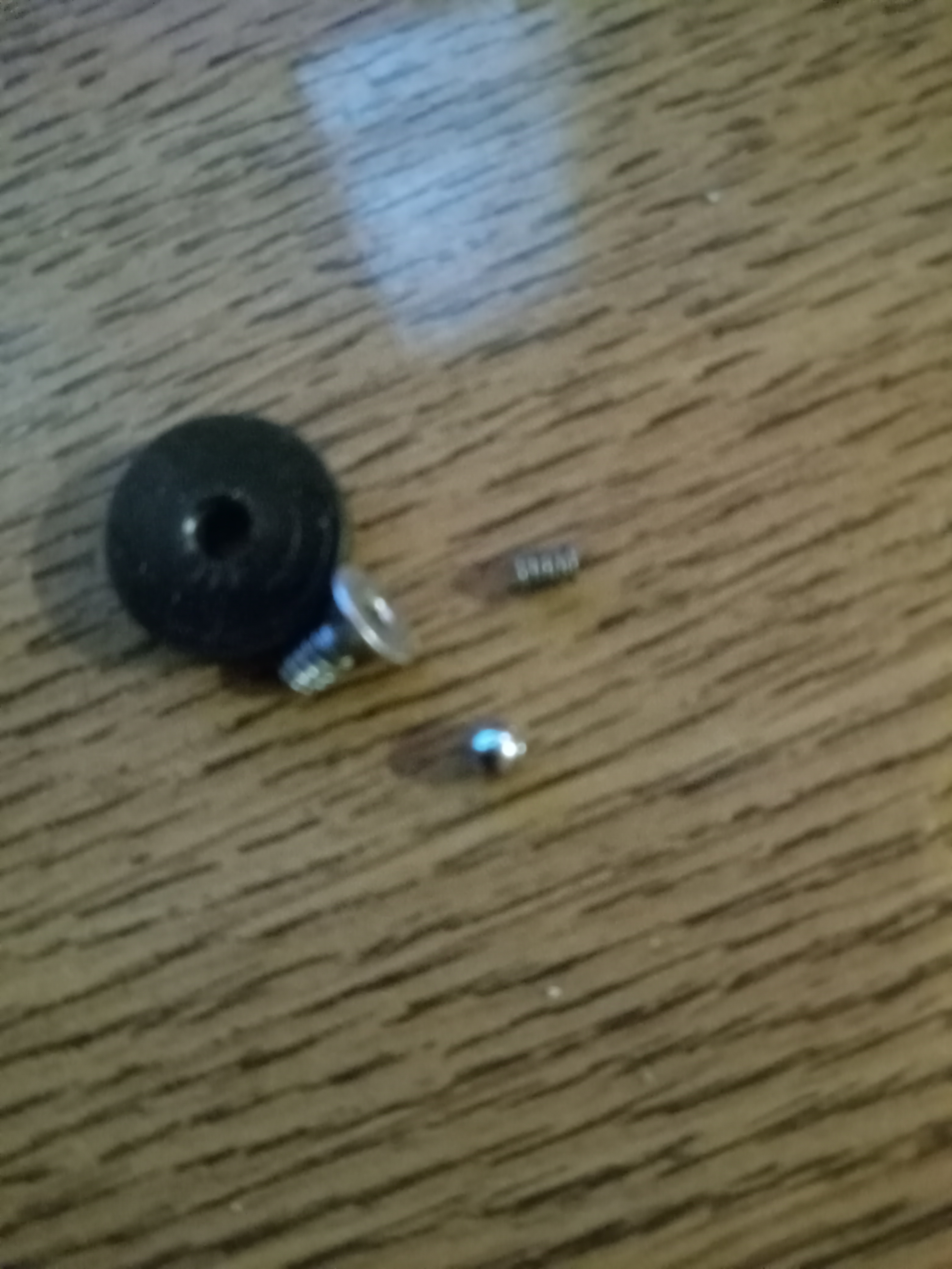

                  This is what my detents look like, is this right
                  • flyweightnate
                    • 1930
                    • Dallas, TX
                    Those are "rebuildable" cocker detents. I find that many cocker detents sit too deep, and an o-ring or nylon washer under the head helps. Doc makes a nice one.

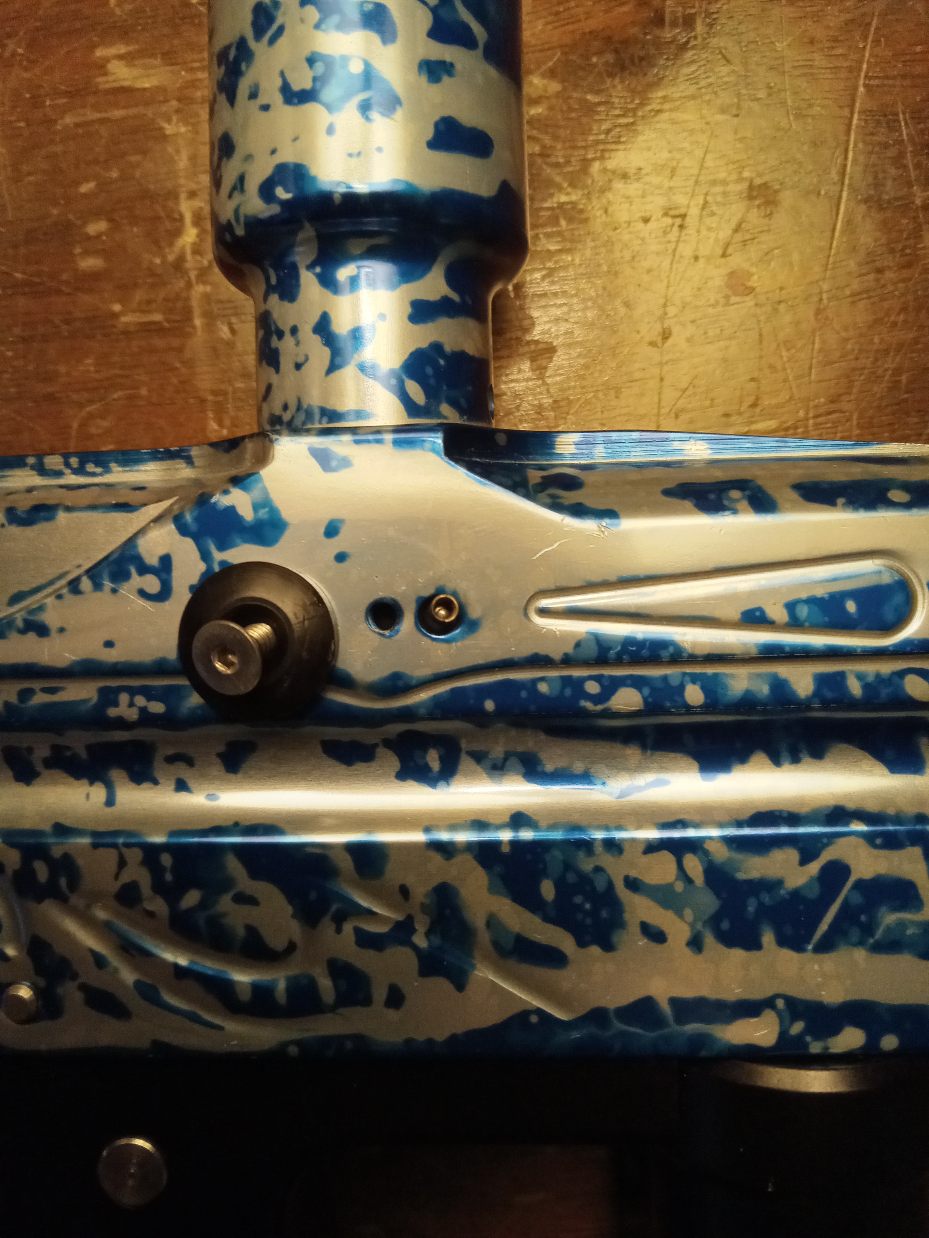

                      Sorry guys I could have taken a pic of the body where the detent goes
                      • Psycho91
                        • 1243
                        • Lexington, SC
                        Here yall go
                        • flyweightnate
                          • 1930
                          • Dallas, TX
                          Definitely a very early detent. Rubber nubbins might work.
                          The brass in the gas through is likely a sintered filter. Knock it out or use a different grip; it won't change the pressure but it will lower recharge rate a lot.
