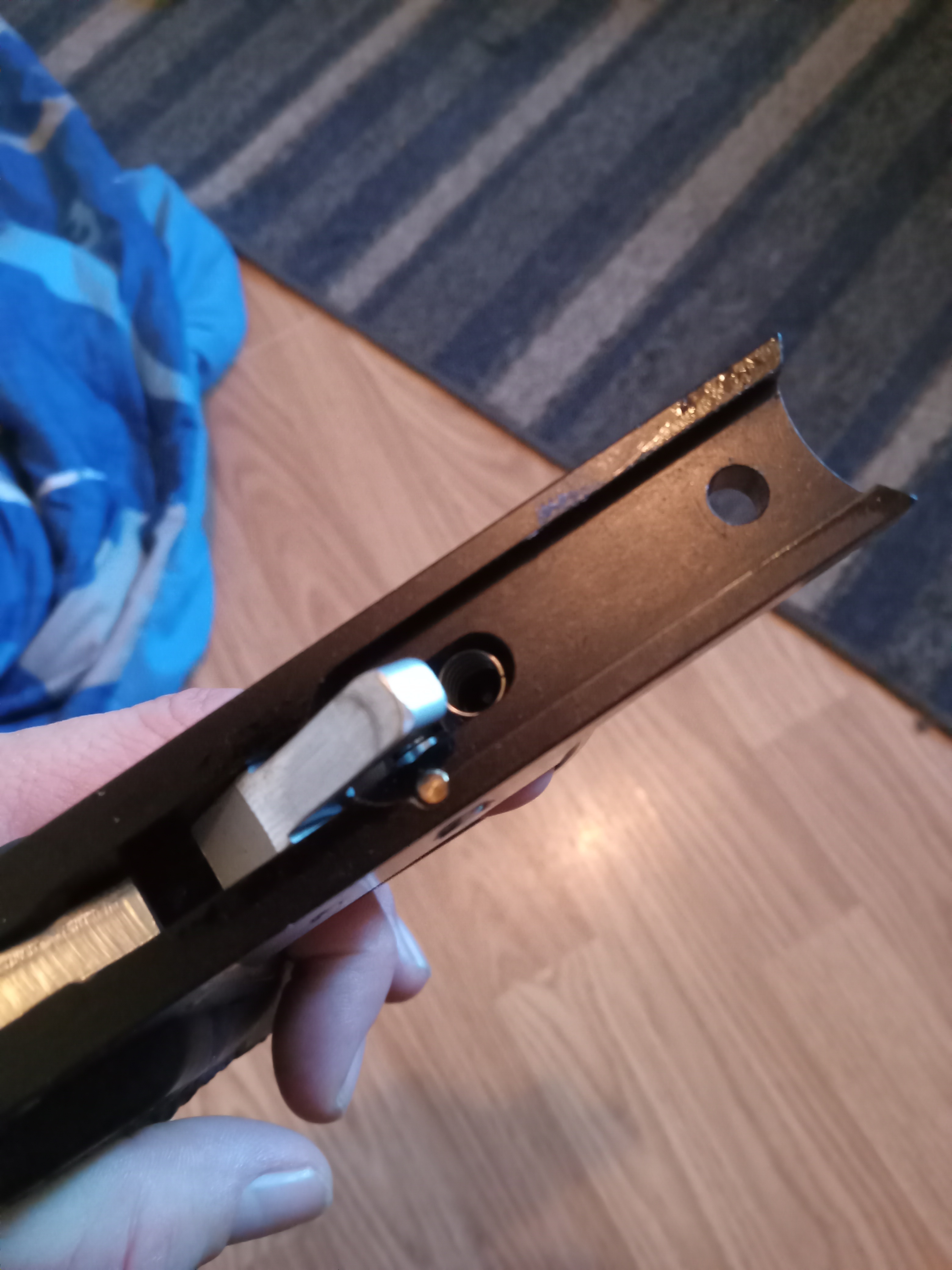

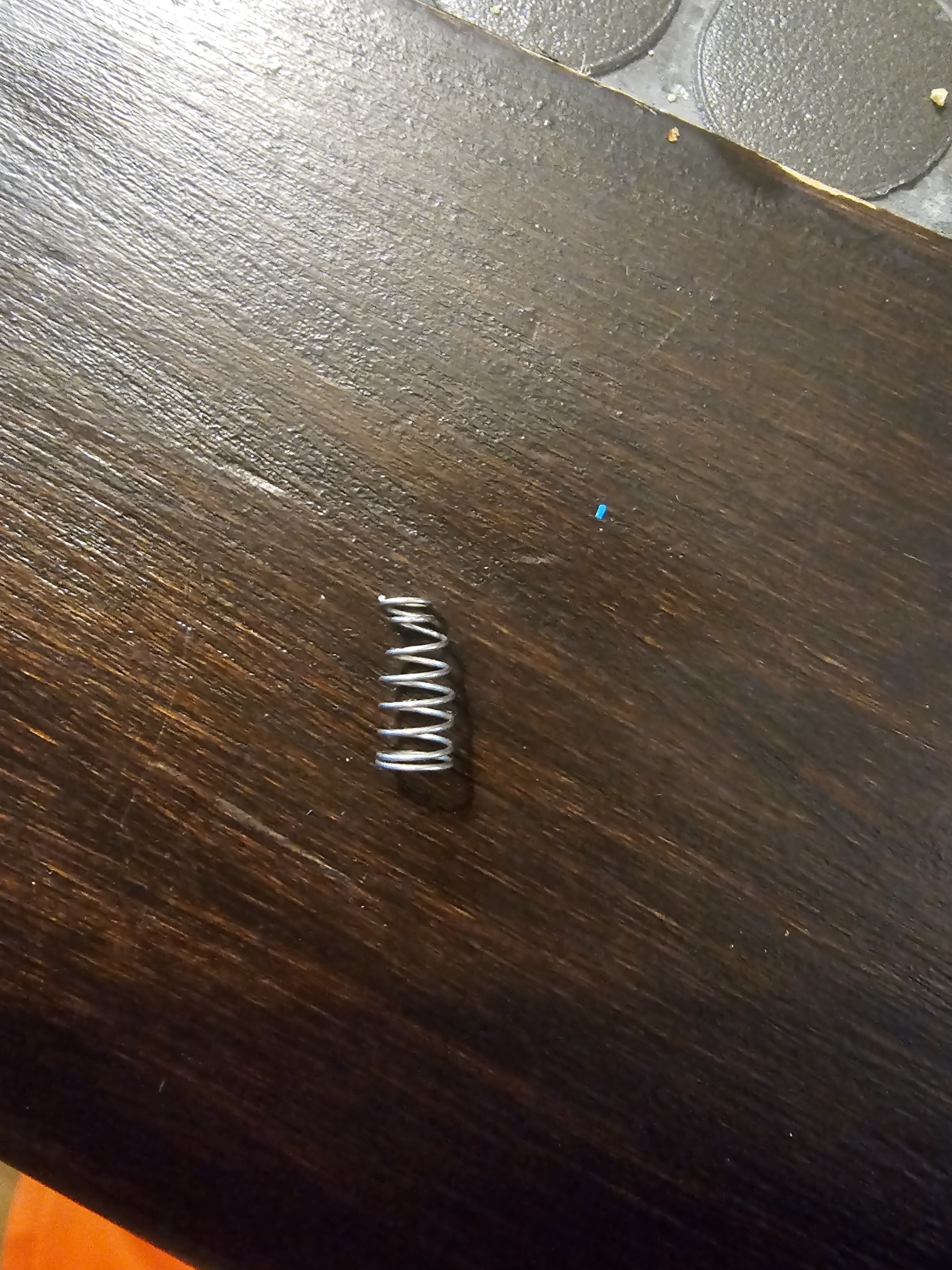

      This spring was side ways between trigger frame and safety button. It looks like it has a small hole in the frame and should be verticle there against the front of the trigger. It wont stay in position in either direction I put the spring. Is there something that should hold it in place?

        It should just sit in a little hole like this

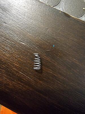

          Thank you for the photo! This spring appears to not be the right one. Inside that hole I did find a black oring which kinda held the tapered end of the spring, but it definitely seems to be shorter than yours and I'm not confident it will stay in place due to not having enough length.

            One trick is to try pen springs
            • flyweightnate
              flyweightnate commented
              Pilot G2 are the biggest I've found!
