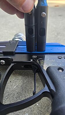

            Mobile posting so can't edit photo titles. But a quick write up should suffice. As another forum post suggested, the shocker bolt is just a bit shorter. The air inlet is massive so it still lines up with the marker port, but depending on which bolt pin is used, you could experience roll back. Probably not that big of a problem for my sentinels (low air pressure so could only test with my Diadem) but with the shockteck bolt and bolt pin, it would sometimes roll past the eyes. With the shockteck bolt and stock bolt pin, it would work without a problem.
            Now here's the real issue. Stock bolt in the Diadem, I was hitting 290+-2fps using 5 balls. I swapped the shockteck bolt in with shockteck bolt pin and stock bolt pin and was shooting 255fps....
            So does it work...? Yes.
            Is it ideal...? Depends on how bad you want to run a 20+ year old marker. I know I still will

              Probably a smaller diameter so you're getting a lot of blowback/ air around it.
              An old fix for rollback was to superglue an oring on the front face. So that'll at least fix that part.
