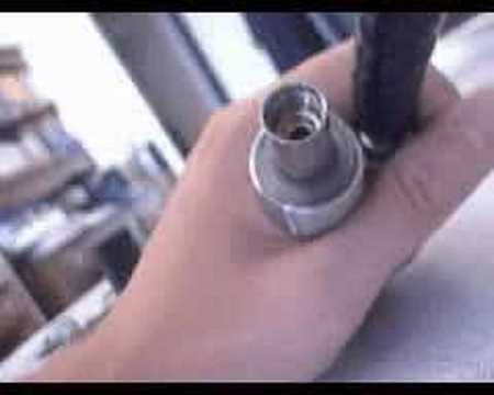

      Automag troubleshooting video:
      http://www.youtube.com/watch?v=7C_1nufgDmU
      MCB: [YOUTUBE]7C_1nufgDmU[/YOUTUBE]
