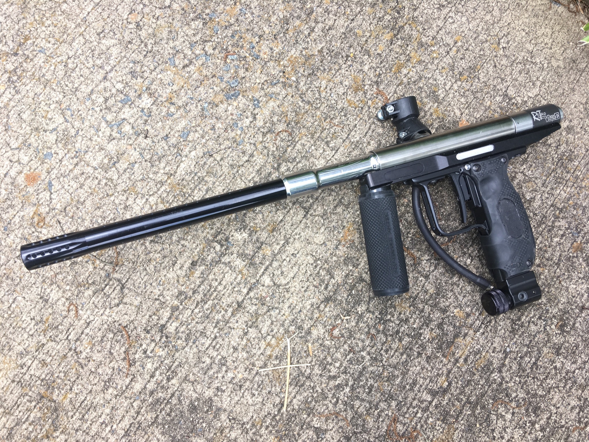

    I'm getting some first shot drop off on one of my pneumags. It has an RT valve with Level 10 and an RT on/off. I seem to remember that first shot drop off is usually caused by a leak with that little o-ring that goes inside the on/off assembly, but I wanted to check before I start fiddling with it.
    Usually whenever I get any problems with my mags, I start by changing all the o-rings, but I just did that over the summer. Don't want to do it again. I'd much rather just change one.
    Pics probably won't help, but I'll add one anyway to show off. 😅
