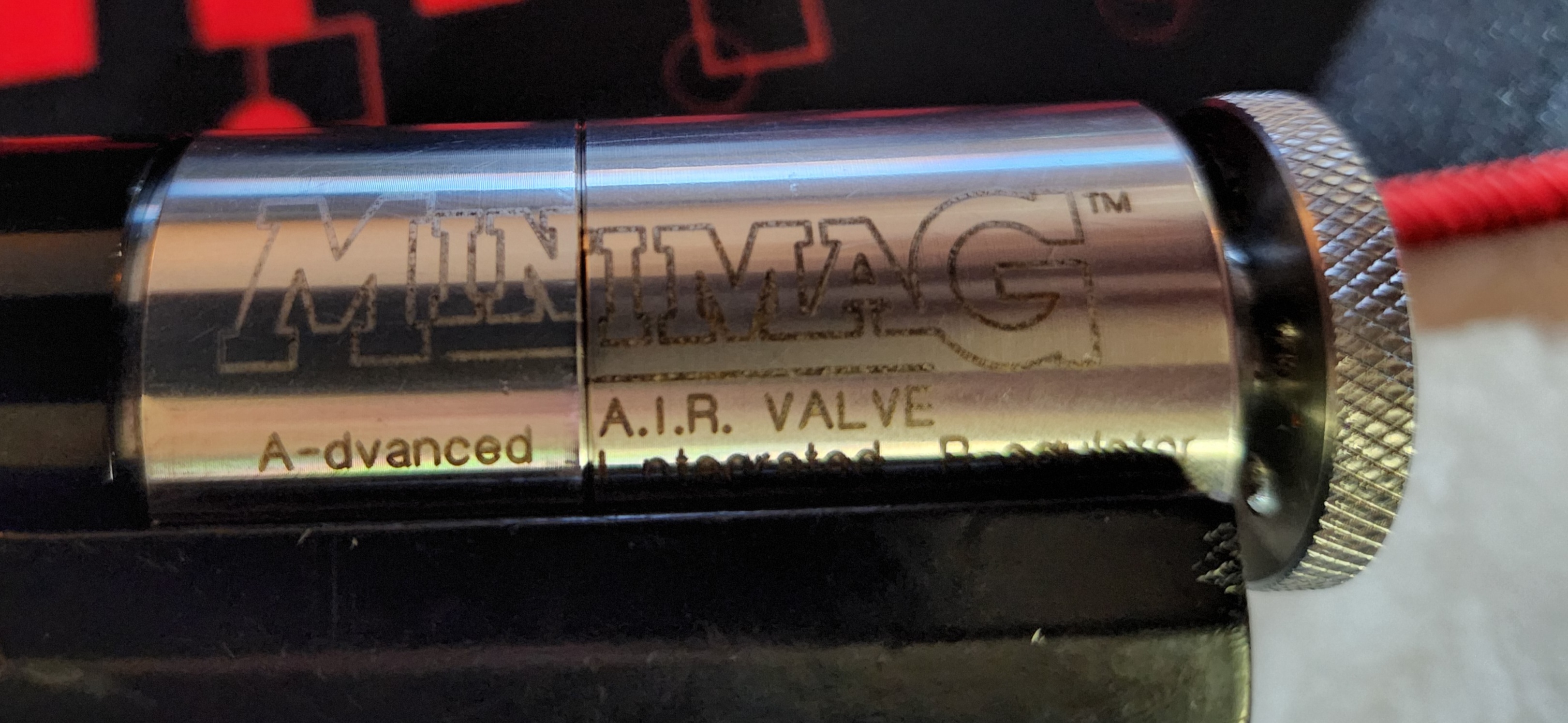

      Replaced the back with the original matching back, along with a full rebuild. Leak has gone away, haven't been able to test veloctiy. However, this was the valve/back alignment required to get the field strip screw in:
      I now believe the cerakot or whatever is messing with the z-pin alignment.
      MCB Feedback
        Jordan commented
        If they don't match up exactly it should be ok, in my experience.
      • MrBarraclough
        MrBarraclough commented
        Having to "misalign" the laser engraving by a couple of mm to get the field strip screw in is perfectly normal for classic valves and completely harmless, though annoying.
      • zinger565
        zinger565 commented
        Thanks guys. I guess the "Gospel of Tom" had me believe everything was precise all the time.
