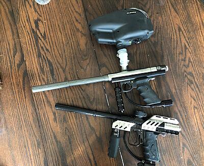

    Mag Bodies
    After playing the last couple years with my Phantom, I decided to dust off my Mags. I'm having chopping issues with the aluminum body that I don't remember having in the past. That gun usually runs the ReTro valve, but I switched it to the classic body to troubleshoot. Both valves work great in the classic body. Both valves chop in the aluminum body. The detent seems fine and the hopper isn't the issue. I've tried both a new Halo and LTR. I know I ultimately need to get a level 10 bolt, but is there anything else I should look at first? They aluminum body is from 2000 ish? Were they changed in later years?
    Thanks!

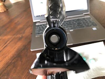

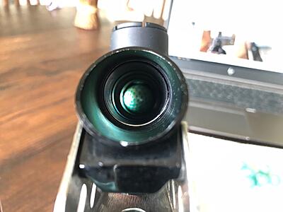

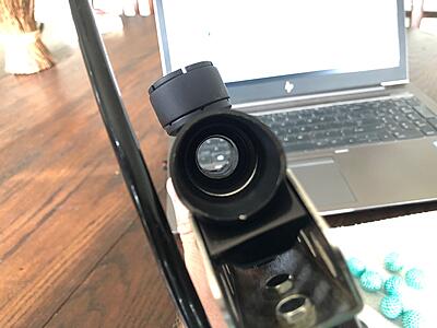

    Take the valve and barrel off, then look through the breach. Feel around for any protrusions: feedneck, screws, seized detent. Any scrapes or burrs... anything that might damage a paintball.
    • mzawlocki
      • May 2021
      • 15
      Everything looks ok to me.
      • Secretweaponevan
        Secretweaponevan commented
        I don't see a detente protruding into the breech.

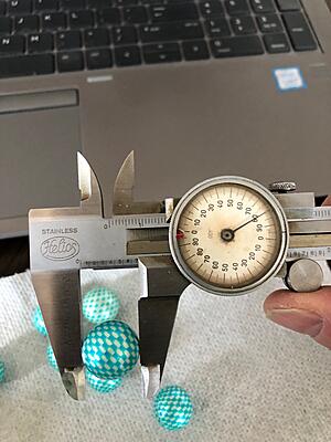

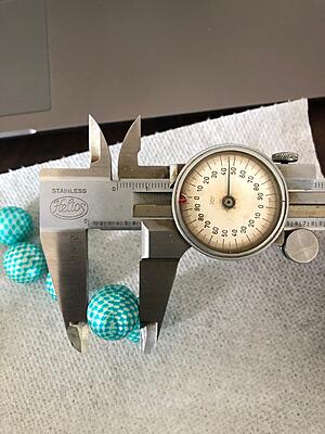

      It has to be a paintball issue. They are small and very out of round. The vertical feed must be more sensitive to bad paint than the power feed.
