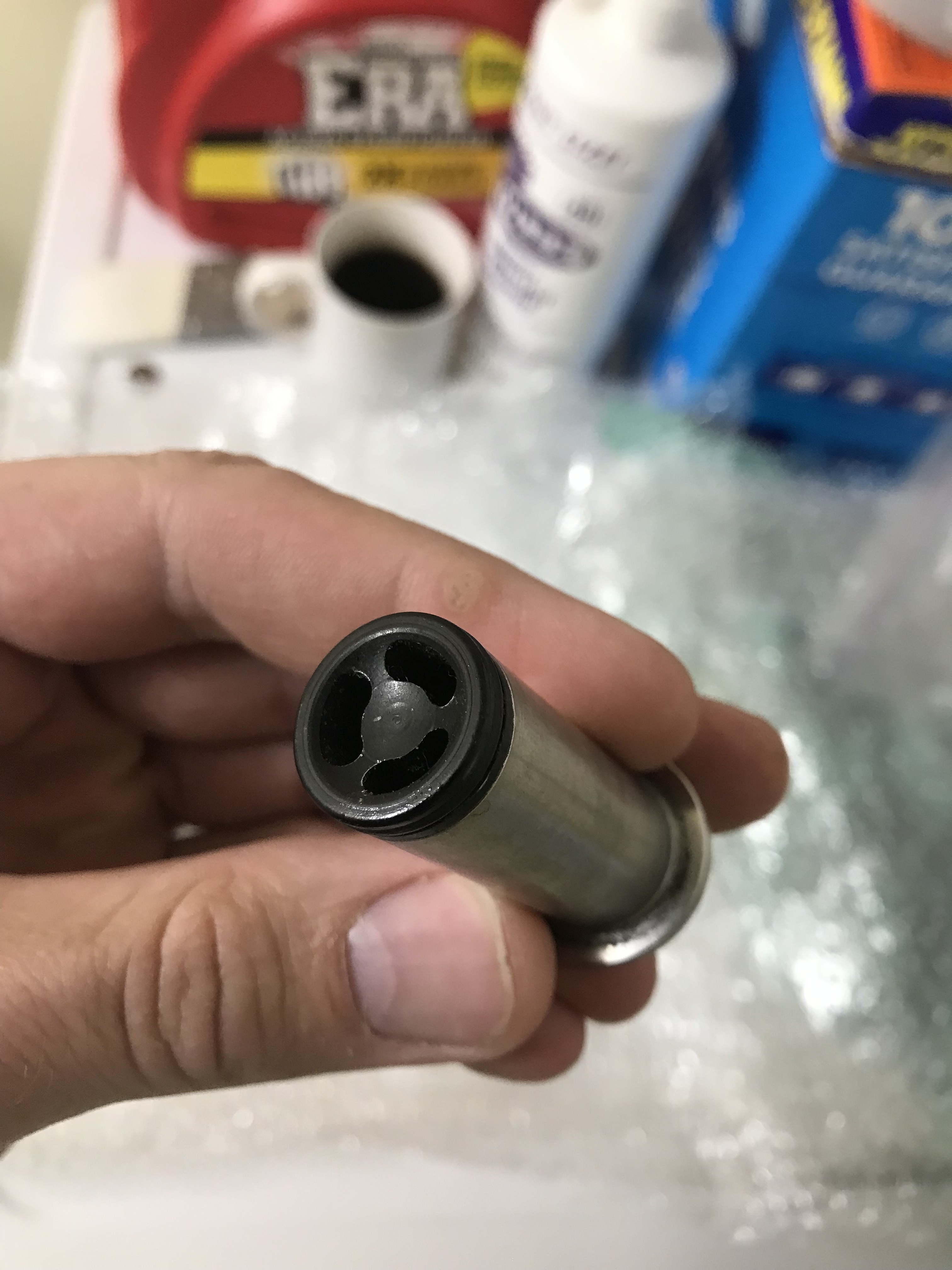

    Does anyone know what type of bolt this is?

    pretty sure that is for a mini or axe.

      All measurements are equal to the AGD bolts I have. I'll get more pics up soon and have it next to other bolts for comparison.

      Missing the larger ledge and o-ring groves at the back of the bolt.

    Isn't that one of the old Venom bolts?

      It might be for one of the Tippmann spools. Tipx, phenom, TCR or Crossover. I'll have a look at mine and let you know.

        Bingo. Venom bolt.

        This came out of my Crossover. It's obviously very similar but it doesn't match. I'm 90% sure all the guns listed (other than the TIPX and TCR) use a different bolt so I would look to one of the others.
          • 4423
          Ah wait.... I'm doubting that's a venom bolt now.
          I'll have to find a color photo to make sure but in the photocopy of their catalog page I have that came with their high line air kit the nose looks to be not black delrin.

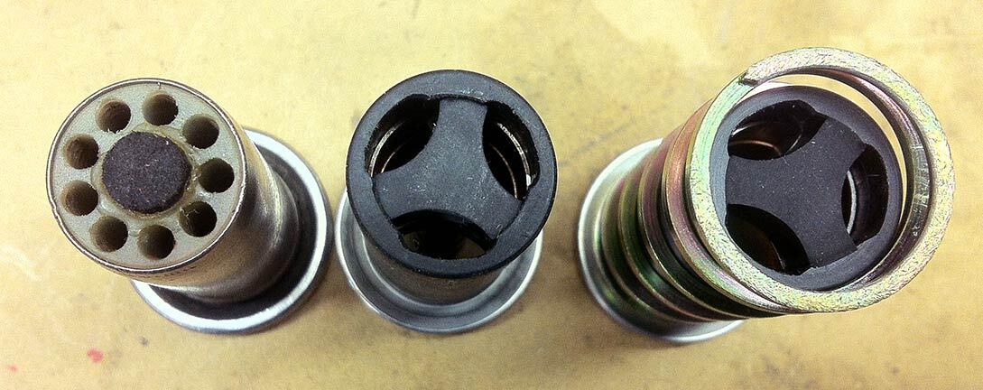

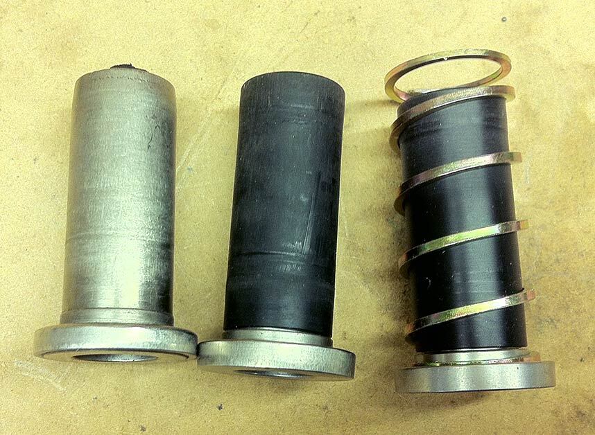

            Closer resemblance to a Super Bolt by ADG but not exact and not a Venom bolt
            https://paintballhistory.com/automag-bolts/
            Left is a Venom the middle and right are superbolts

              My vote is a TIPX bolt.

                It looks to have an oring on it so it's definitely not a mag bolt.
                  scottieb commented
                  It looks very much like the Tipx bolt pictured. What am I going to do with a Tipx bolt? Geesh!

                scottieb You’re gonna have to find nearly a whole gun just to get that bolt to work.
                  scottieb commented
                  The trouble is, I'm not a modern era marker guy. The most modern marker I have is a balance valve Spyder - and I have it solely to swap the valve into an old Spyder. I've no interest in a Tipx and have even less interest in anything Tippmann. I'll post it up and someone can get it to use.

                  Phenom bolt???
