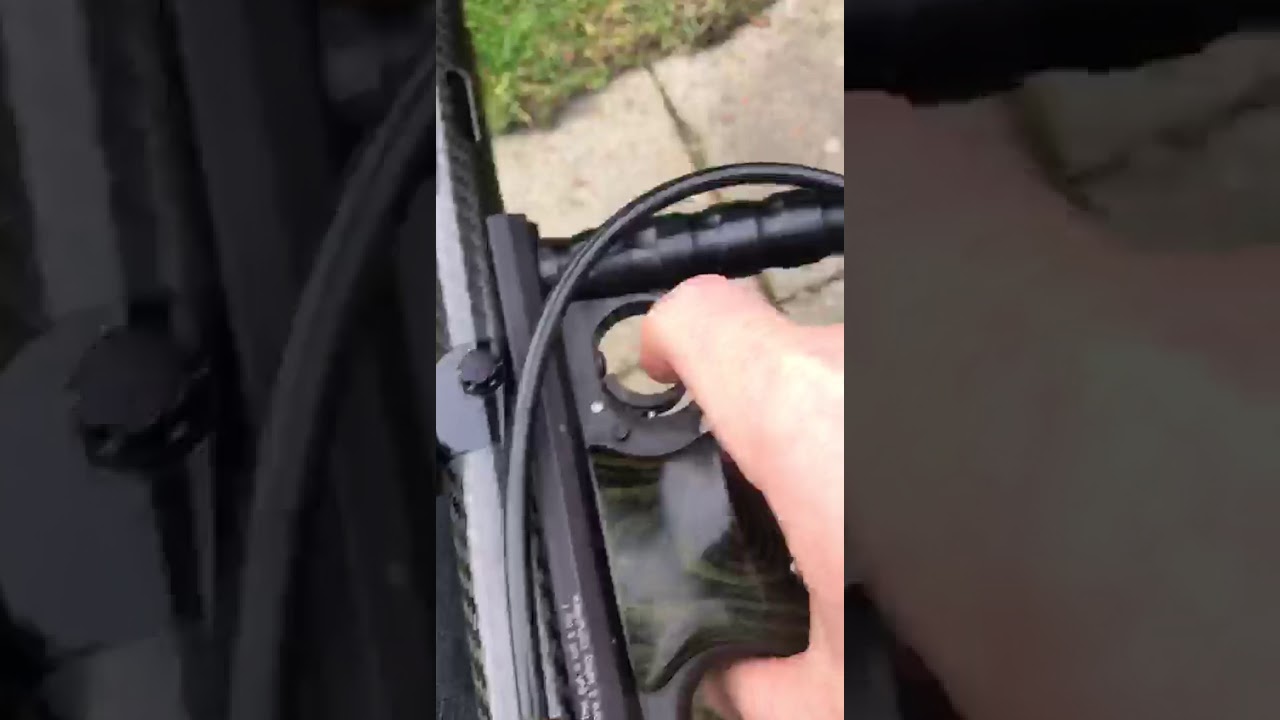

    Soooo, my current build feel's like its some sort of a runaway gun compared to my classic RT.
    What do you guys think?
    To my knowledge, i need a longer On/Off pin. Right now there's a .745 in it.
    Is there something else to check/swap?

    Looks like you need to adjust your trigger rod, you need a small gap about the thickness of a credit card between the tip of the trigger rod and the back of the trigger so the on/off can operate correctly.

      LukeAO I gonna check back later if there's a big enough gap, thanks Luke! (normally i set it up to be at least 2mm)
      Jordan its the standard RT on/off

        2mm is way to much think .03"

          It took some time, but now she's runinng fine. Semi and RT
          https://www.youtube.com/shorts/mc8kHcNQDXk

              Do you know what your ROF is?

                So, after some rocket sience (audio file/garage band) i tried to count the bps on the rt part for one second (near the end of the yt short)....its around 20'ish bps. With 850psi preset.

                  20bps, yeah that's definitely too rowdy for recball. Glad you got it toned down!
