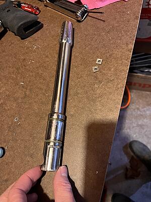

    Hi guys, I’ve got a question for the mag guys and girls.
    I picked up a Minimag with some sort of shortish aftermarket barrel and it works well, velocity stable and all that after an easy o-ring rebuild. But the accuracy is not what I remember from my old mag. My old one had an RT barrel, so I’m thinking about picking up one of those, but I’m wondering if the paint is just less round and smaller than what I used to use 15 years ago and an RT barrel would get the same result? What barrels have y’all been happy with? I don’t know that bore matching with a freak kit is necessary, but maybe an old barrel is way too big for modern paint.
    i do have the original aluminum Minimag barrel to try next time to see if that improves it
    Edit: here’s a picture of the barrel that I’m not super impressed with

        I didn’t realize there are two piece twist-lock options. Is the picture above of mine a j and j?
        is my accuracy issue something besides the barrel? I’m thinking about doing a light polish on the inside of the barrel to see if that helps
          scottieb
          commented
          That's a Taso barrel.

                I found an interesting J&J barrel on eBay with no porting. It seems rare to see one without any porting. Currently I’ve got the stock 8” barrel without porting on it and it’s shooting better than the short taso that I pictured above. I assume the porting helps clear out any barrel breaks better? And quiets the shot down. Any other disadvantages to getting one unported? It’s a 12 inch, so that’s about right efficiency-wise from my understanding
                • Grendel
                  Grendel
                  commented
                  Ported barrels in general are worse then non-ported when it comes to paint in the barrel after a break. They act as a reservoir for paint after each shot and make it harder to shoot the barrel clean. Unlike non-ported after a couple shots the bore is reasonably clean as long as you did not break the paint in the breach. Break paint in the breach and not much you can do until you can tear it down and get that paint out.
