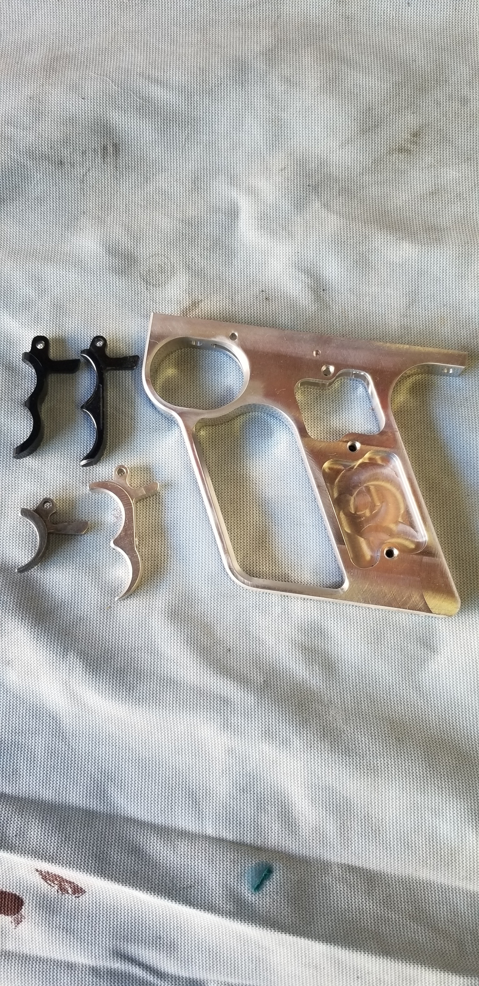

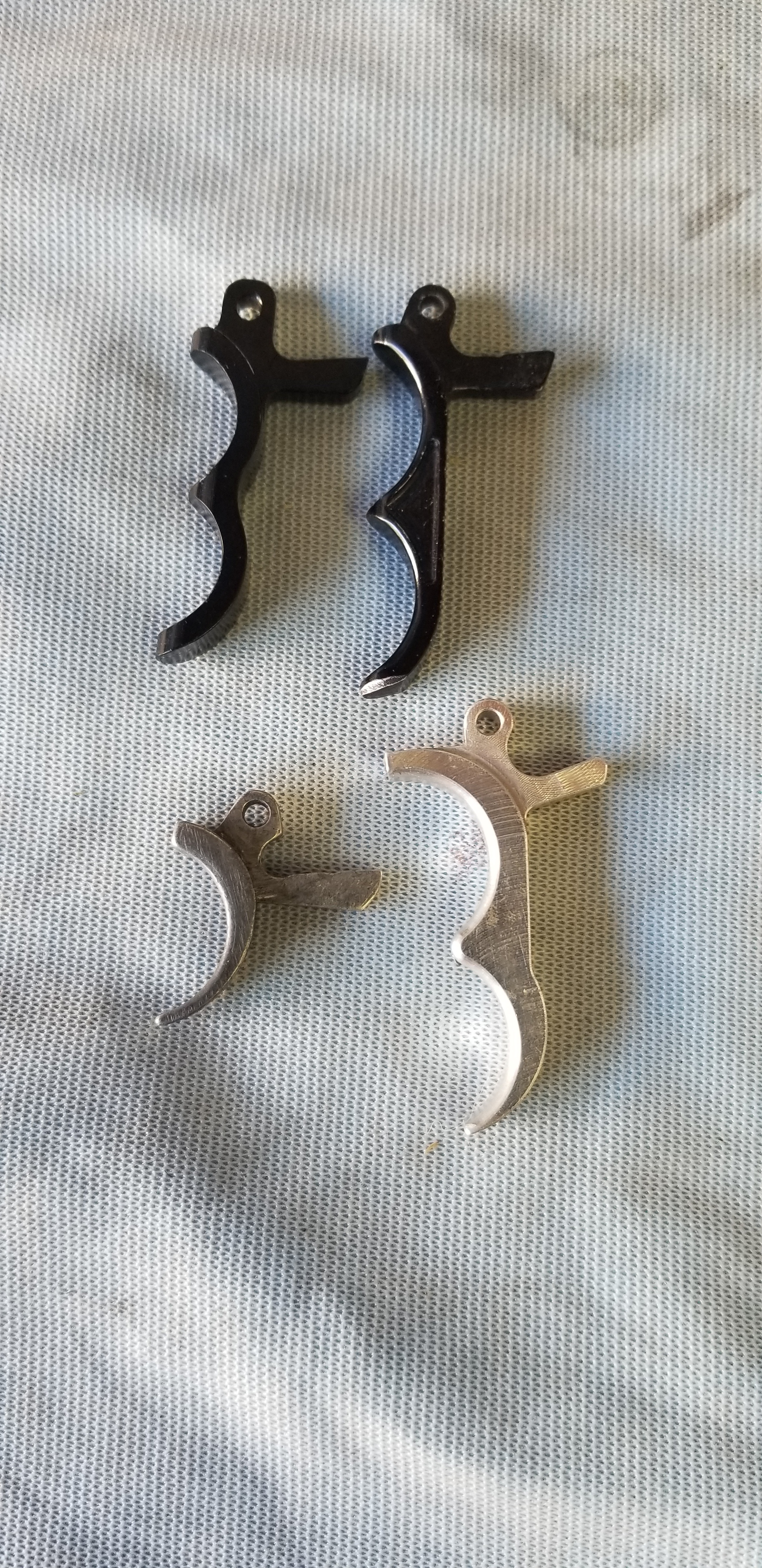

    Hey all. Finally going to put this frame to use. I need a single trigger for it.
    Anyone knowing this single trigger can be anod? Or am I better off cutting down one of the double triggers?
    If you by chance have a single or double trigger that is already cut down. And wanting to let it go, hit me up.
    thanks for the help

    Original 'Mag single triggers are cast, which means they could be aluminum, or more likely a potmetal. If there's a significant percentage of anything but aluminum, like tin or zinc, the anodizing process could damage it.
    I don't personally recall trying to anodize one, or seeing one anodized, so I'm not sure I'd risk it. Cutting and reshaping one of the doubles is the safer bet.
    Doc.

      They are definitely pot metal and they will melt (easily) under a propane torch so a high zinc content. They are not dissimilar to Sheridan triggers.

    Take one of the double finger triggers and cut it down to a single trigger. I have done that in the past to get good single swing triggers from my Mags.

      Ok that is what I had figured, just wanted to be sure. Thank you both.
