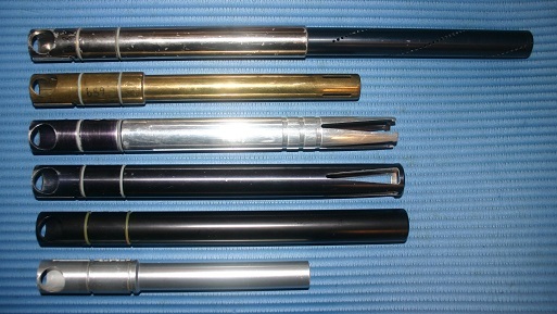

    I was tired of being inside, and decided to rebuild my old 3k FlatLine and run some chrono tests.
    Flatline reg rebuild - Quite easy really... First time for me...
    https://www.mcarterbrown.com/forum/p...ide-56k-beware
    Tank setup: 68/3000, Flatline reg set to 850psi output, not changed during tests.
    Gun setup: Classic MiniMag, level 10 bolt, benchmark frame
    Ammo: Well used reballs
    Chrono: Master Shooting Chrony
    Barrels used: 16" SmartParts, 10" J&J brass, 11" Modified Crownpoint, 11" unmodified Crownpoint, 11" Bull, and a stock 8" MiniMag barrel. (ID measurements take at the bore end)
    Shot strings: 10 rounds over the chrono
    Shot tempo: Drop a ball in, line up over chrono eyes, shoot, repeat...
    Results:
    SP 16" (easily the quietest of them all) (.689)

    Click image for larger version  Name:	barrels used.jpg Views:	13 Size:	66.9 KB ID:	632391
    Click image for larger version  Name:	gun setup.jpg Views:	13 Size:	81.5 KB ID:	632392
    In a friendly game, I wouldn't have issues with any of these barrels.....

      Interesting that the stock barrel had the best std deviation. Did you use the same 10 reballs for each test?
      • Walker
        Walker commented
        No! Why didn't i think of that! I should have used the same ones!
    • jetenginekyle
      • Jun 2023
      • 580
      "No! Why didn't i think of that! I should have used the same ones!"
      lol now you gotta start over!
