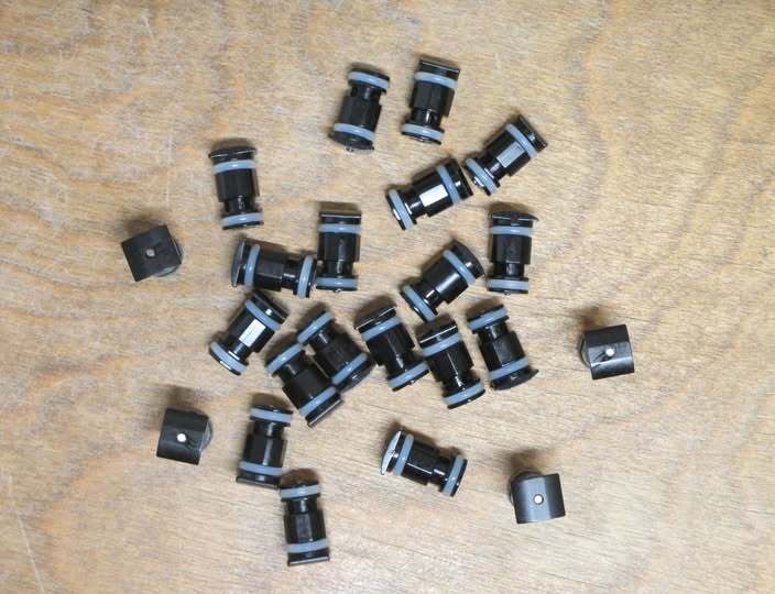

        I've been working on a new on/off, I'm calling it the Lc Hybrid on/off. I pulled the design from the AGD Classic, RT, and ULT. The prototype #1 (P1) was released to the public for testing, it worked well, without complaint, but I found two issues that was easily improved on. I made the changes, ask everyone to destroy the P1 and I replaced it with the P2 for more testing. Again, zero complaints so far. I have 26 on/offs being tested over the past few week's, they are getting some field time, back yard, and bench testing with positive feed back. So far it's proven to work in the my LcX, Classic, and X valves, it will not work in the ReTro style valves with the on/off top stepped oring bore. We've been testing in Pneumags, Hyperframes, Classics, and Emags with positive results. Prototypes were made from 6061 aluminum but production units will be made from brass. That said I have made one last change that will end up in the final version, so I guess that would make the final version a P3.
        Here's a pic of the P2's

          What are the benefits of your on/off? Love seeing the new product, unclear on what difference to expect. Lighter trigger pull?

        Benefits(?) Fires out of the gate with brand new orings and on the first or second pull (compare that to the RT on/off it doesn't 99.9% of the time, and has gotten worse over the years) Works in the Hyperframe, Emag, Pneumags and Classics, which implies it has a lighter pull, not walkable in mech, but sings with a pneumag. I found it will run my T-rex at half the LPR pressure on brand new orings, which is impossible with the RT until its quite broken in. I find the trigger pull to be somewhere between the RT and ULT but might get lighter as the oring's relax over time, that is yet to be proven as this is all brand new stuff. The Hybrid on/off was not developed or meant to be in direct competition with AGD or a replacement to what Tim sells, it's simply inventory for my custom marker project, designs (as always) reflect what I can produce in my small shop with the one cnc machine I have.

                    Project was completed about a month ago

                      I can attest to the Luke’s Customs on/off.
                      I installed one in my Micromag, it only has a level 7 bolt and it made a huge difference. I played against guys with newer mech guns and did not feel outgunned.
                      I think there were using Planet Eclipse guns but It’s hard to for me to tell the newer guns apart. The trigger is so much lighter now. I can definitely put more balls down range faster than before. I didn’t have any breaks either. I’m running a stock twist lock barrel with Beared Works detents and a VL Revolution hopper.
                      I just bought four more of the LC on/offs for my other Mags.

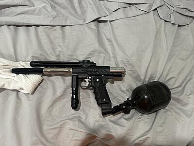

                        What size pin are you using with it?Ive been buying bits and pieces for another mag build and actually bought Luke’s empire feedneck ring…and the wedge thingy..both things I was trying to have Luke make back in the days… and I ended up making a run of empire feed-necks of my own…This is my current situation still waiting on a few bits and poieces….
                        https://www.automags.org/forums/show...r!!LIMITED-RUN
                        https://www.automags.org/forums/show...***FEEDBACK***

                          Thats an awesome setup you have have.
