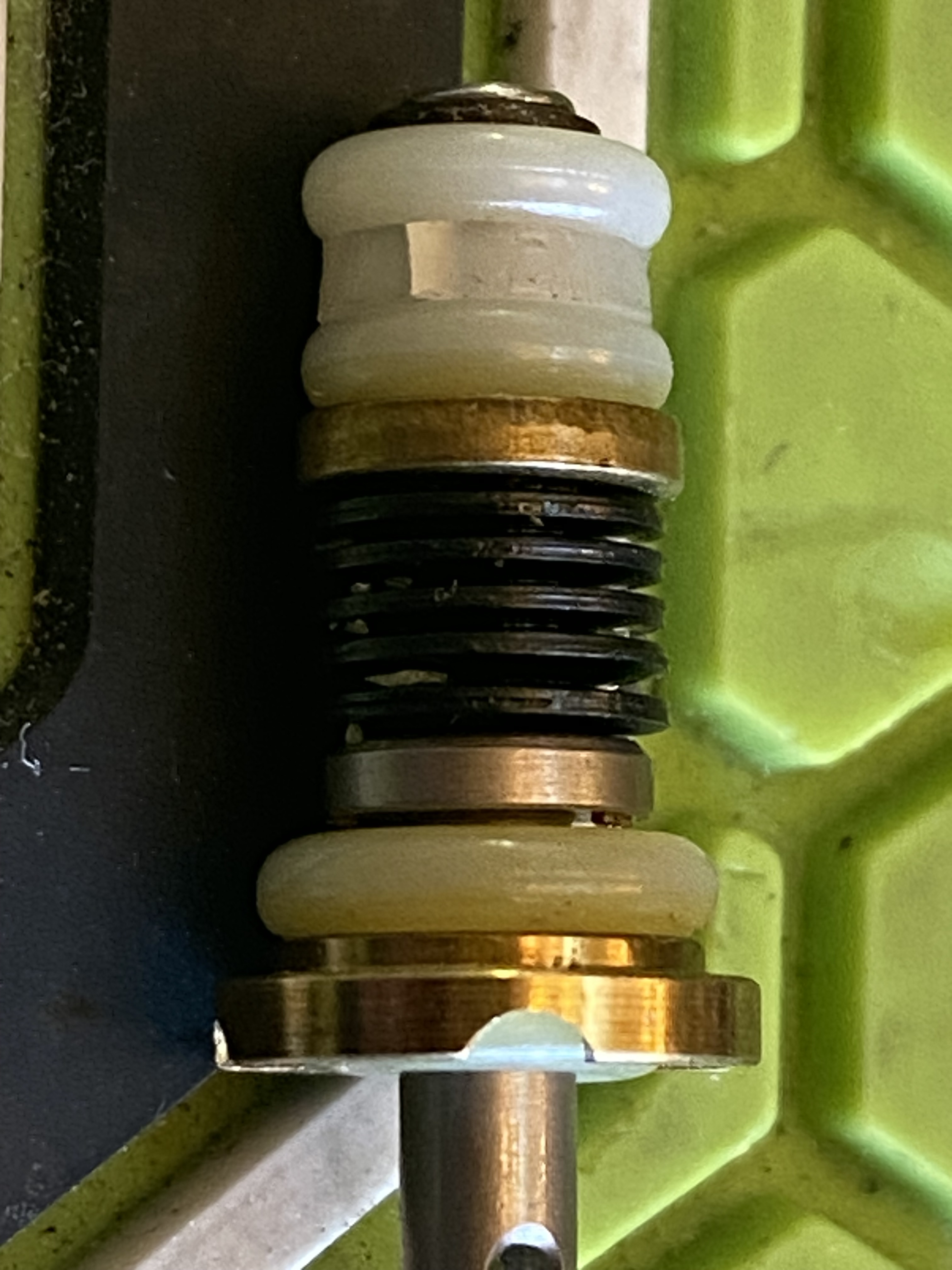

              • JonM
                • 1326
                • Landisburg, PA
                I believe you’re right. I pulled the pin out and this is what I saw. I thought I had seals in my kit, but apparently not. I’ll need to spring for the rebuild kit after all.

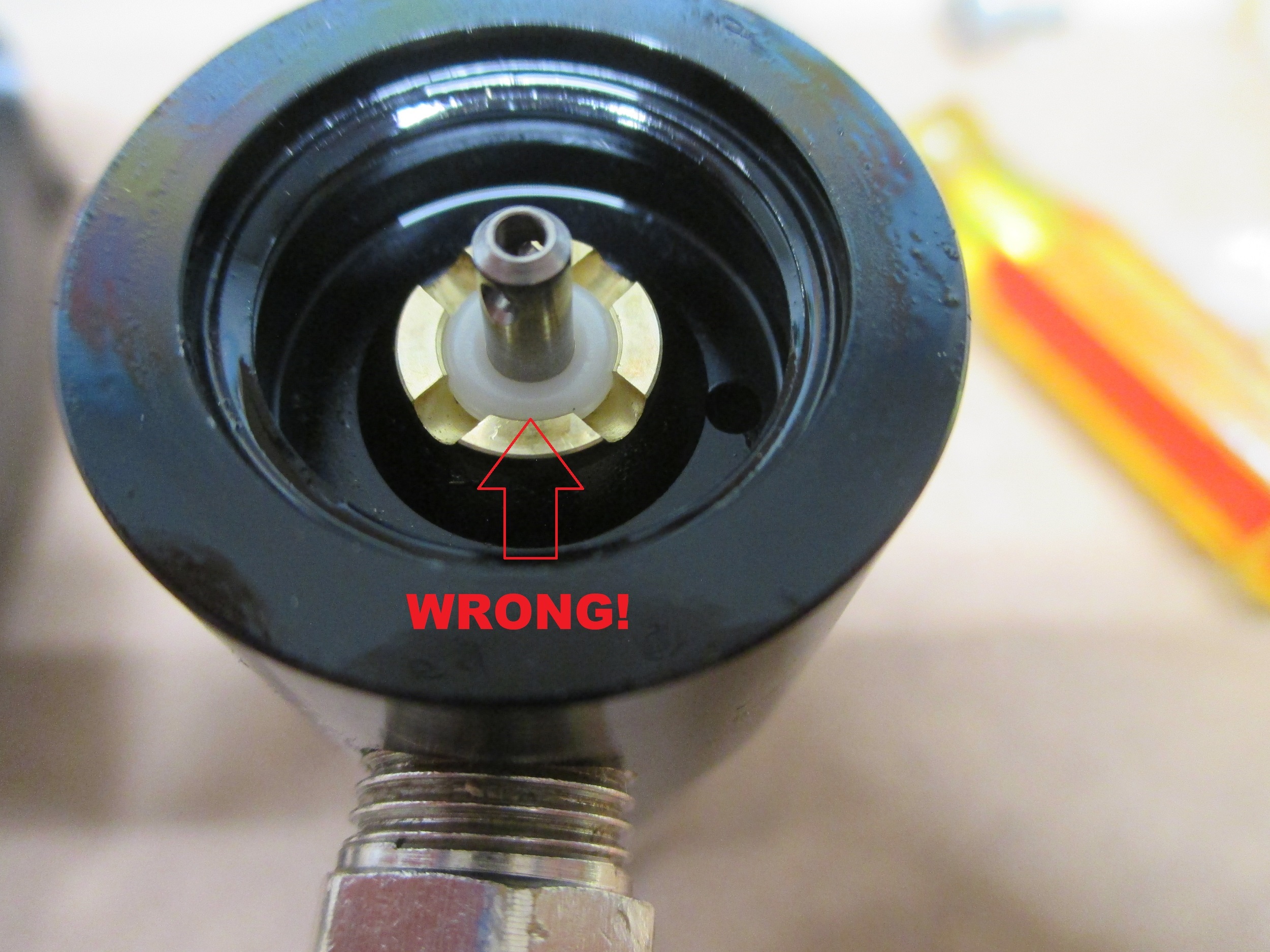

                • LukeAO
                  lukescustoms.com
                  • 173
                  • Arizona
                  It looks like you installed an oring in the back or your reg seat, it doesn't go there it goes in the nose of the reg housing
                  • JonM
                    JonM commented
                    Interesting. That’s how it came from the previous owner.
                • JonM
                  • 1326
                  • Landisburg, PA
                  Mystery solved! Thanks, guys. Moving that o-ring did the trick. I still went ahead and ordered a rebuild kit just in case (I’ll need it eventually anyway). At least the marker is controllable again.
