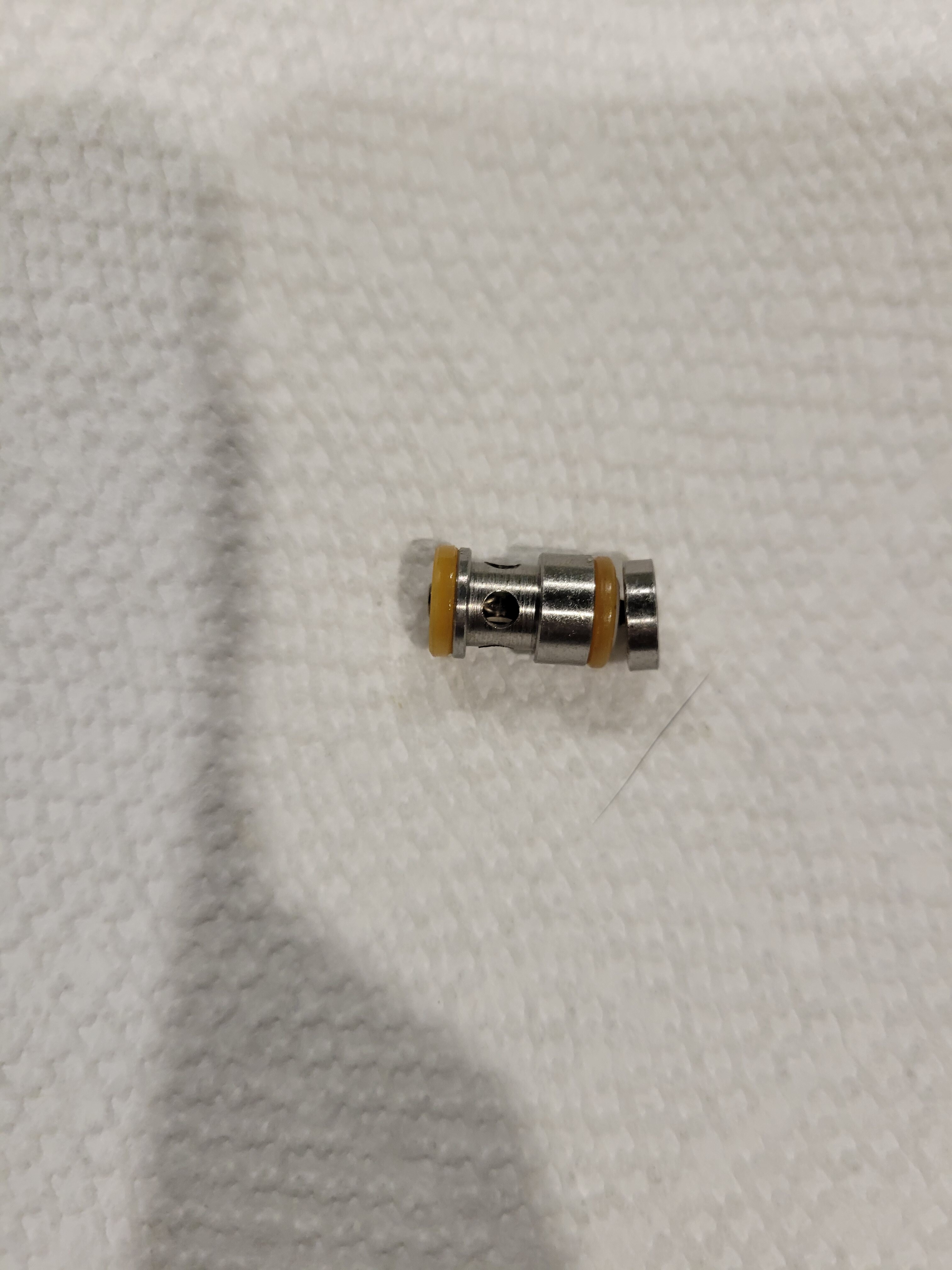

    Bought some what of a franken valve for cheap has a ans phase 2 back, ans bolt and a reactor on/off. Was hoping someone out there might be able to clarify the oring config and direction of the insert. I'm having issues where the trigger won't reset and is dead. If I crank up the pressure it will vent out the back and can hear air purging down the bolt. Came out of the gun like the picture. 20250424_195952.jpg

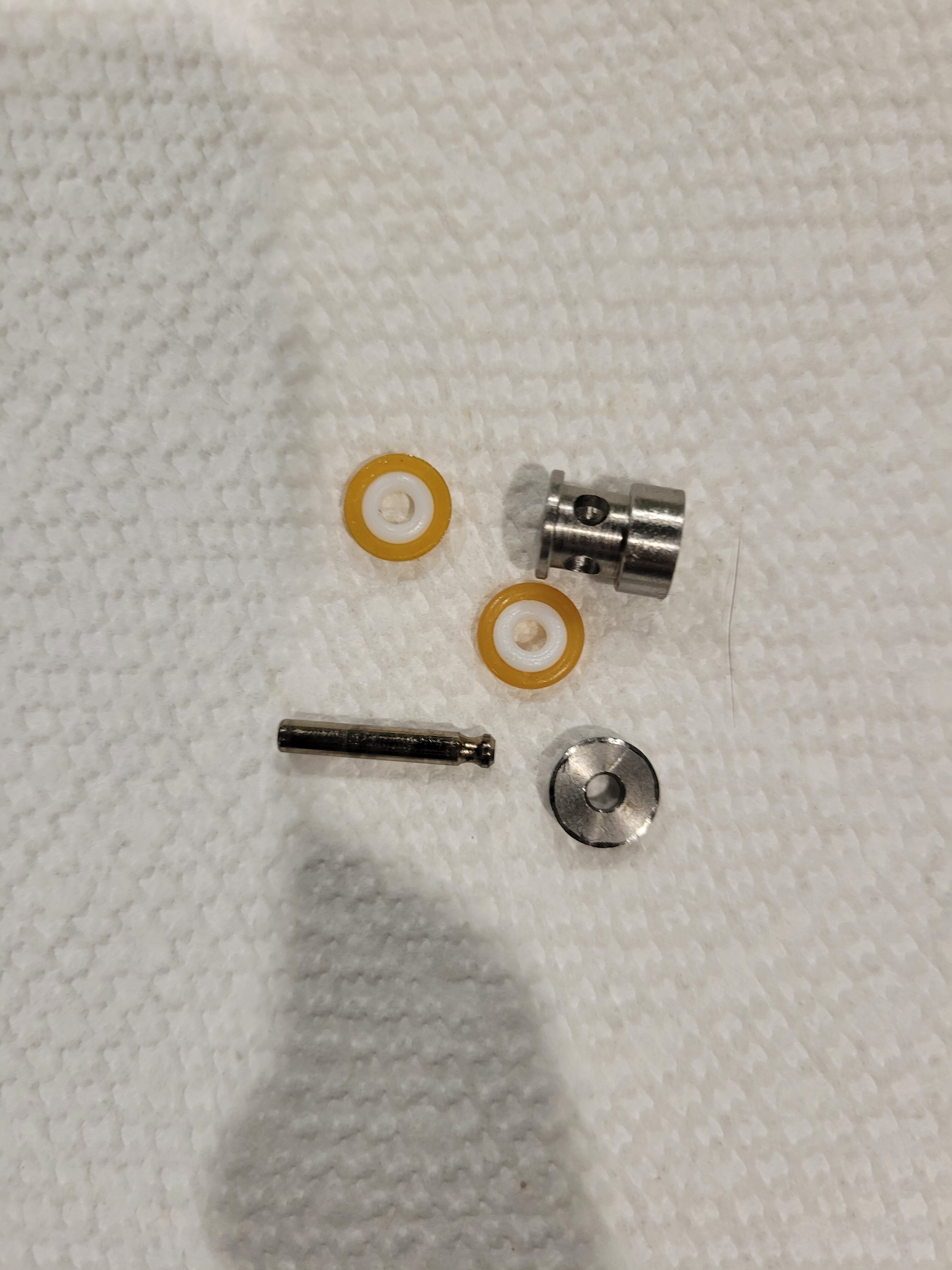

    This is what it had for o rings

      I replaced all the rings with new ones out of a fresh agd kit as the larger old ones literally crumbled. Only pictures I can seem to find online only show a single large oring and a single small so hopefully someone out there has one and can shed some light. If I can't get it to work gonna probably just order a new classic on/off for it.

    That looks correct. If you push on the bolt does it reset? Wonder if the bolt spring is weak or maybe the spacer oring too tight.

      For spacer oring you talking the one behind the power tube or the rings in the on off? I feel like to keep that little disc in place you gotta kind push that disc down a bit maybe it's squishing down too hard and bonding the rings up. I oiled them up a bit when I popped it all together. This has me scratching my head as I've rebuilt a bunch of regular classic valves and never had an issue. This one is just fighting me.

      I am referring to the power tube. oring and the powertube spacer. Make sure that is assembled correctly.

              Pulled it apart today....sear is good and chamfered over on the tip. Surprised I didn't check that before...should be an easy fix.
