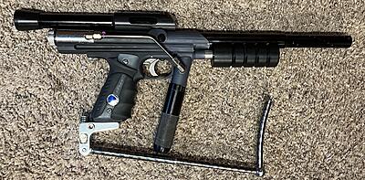

    The couple I did I removed the original feed, welded a nut to the body, hollowed out the bottom of a delrin phantom feed to hide the nut.
    This is the one I did for myself.

      Cougar that mag is so damn sexy.....really well done my friend.
