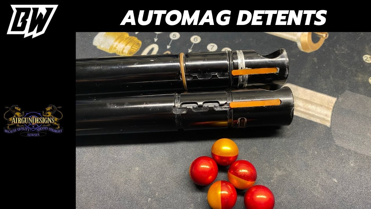

        You only need one detent...One designed for smaller paint. https://beardedworks.com/products/bw-twistlock-detents
        I designed these a few years ago and have had no issues using smaller paint. Including down to 0.675 using a rotor. They do need to be fit properly to the barrel.
