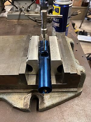

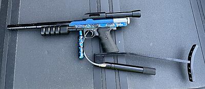

    Playing a stockclass game this weekend and didn't want to run a stick feed in a feedneck so I drilled and tapped my ule body for a modified phantom delrin feedblock. Came out pretty nice, first time trying this mod on a ule body

    I like that look, especially the site window in the feed block. How is your efficiency on the 12 gram setup?

      Not bad for a pump mag, I got 20 shots at full velocity and then it just completely died on the last shot
      Having a freak bored barrel definitely help with efficiency

        That looks great, you did a good job mounting that tube.
        20rds for a mag seems way better than what I would have guessed. I have never seen any talk about increasing efficiency on a mag, is there much you can do other than bore sizing? Maybe switching micro line or hardline?
        • alpha_q_up
          alpha_q_up commented
          Devolumizing the valve is key in getting massive gains on co2 I did it with a valve I had and got 30ish shots consistently and 3 or so with drop off, although outside temp(95°F) and playstyle does play into how fast you'll empty a 12ie, devolumizing your air line if you can will help, I used a hardline that I put weed whacker string in to help reduce the volume of the line, did it do anything ¯⁠\⁠_⁠(⁠ツ⁠)⁠_⁠/⁠¯ but it felt like it did
