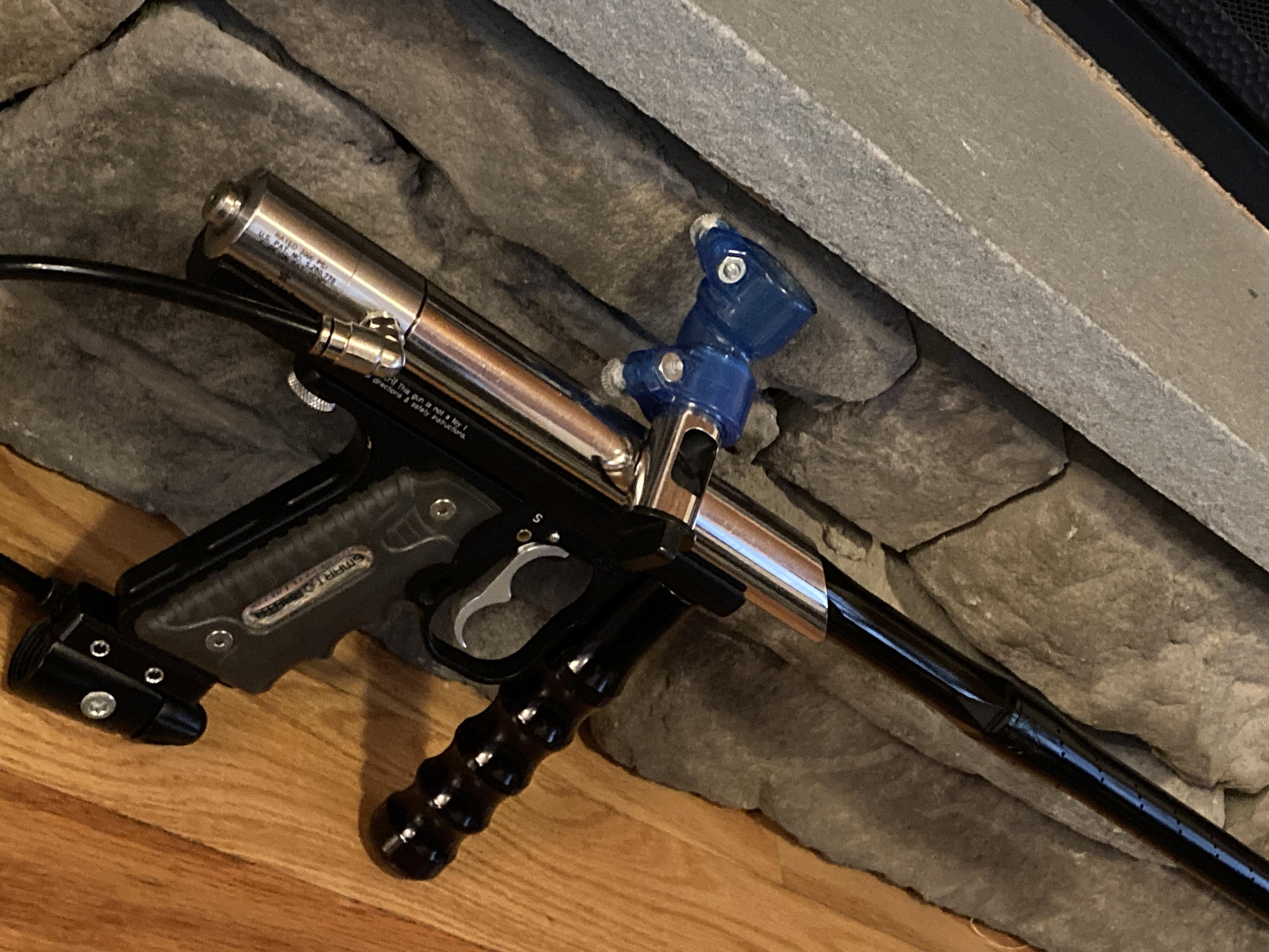

            Good price for the marker you bought. But you should post a picture for our enjoyment.
            The classic valve is reliable and shoots great. Attached is a picture of mine.
