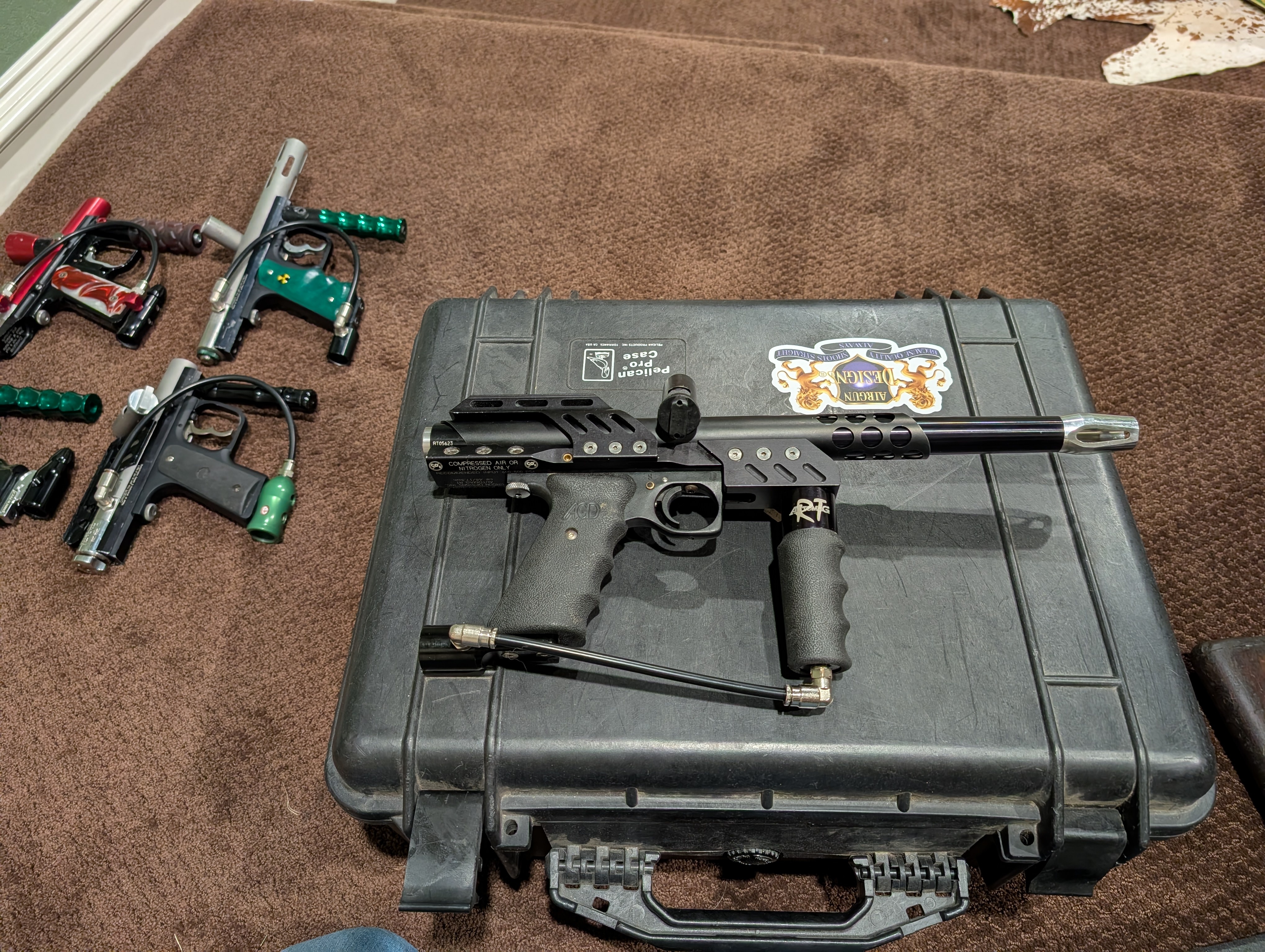

    Got the RT running
    Bought this a few months ago and it sat since I haven't had time to trouble shoot it. Bought it with a known banjo leak and a level 10 leak since it was never tuned. Got the level 10 dialed after some spacer fun and turns out the mystery banjo leak was just the two o rings on the regulator valve pin PXL_20250908_015327575.jpg . Rips like a champ now. Now I just need to get back on the micromag project and get that one looking pretty again.

    Good job, welcome to the RT Classic gang! That one looks very clean, It must have sat in a closet, or been very well treated, by the previous owner.

      Yeah picked it up from Hobbes and when it came I was like holy crap this looks pretty much brand new. My only mag I'm gonna leave bone stock as received other then a tune up.
