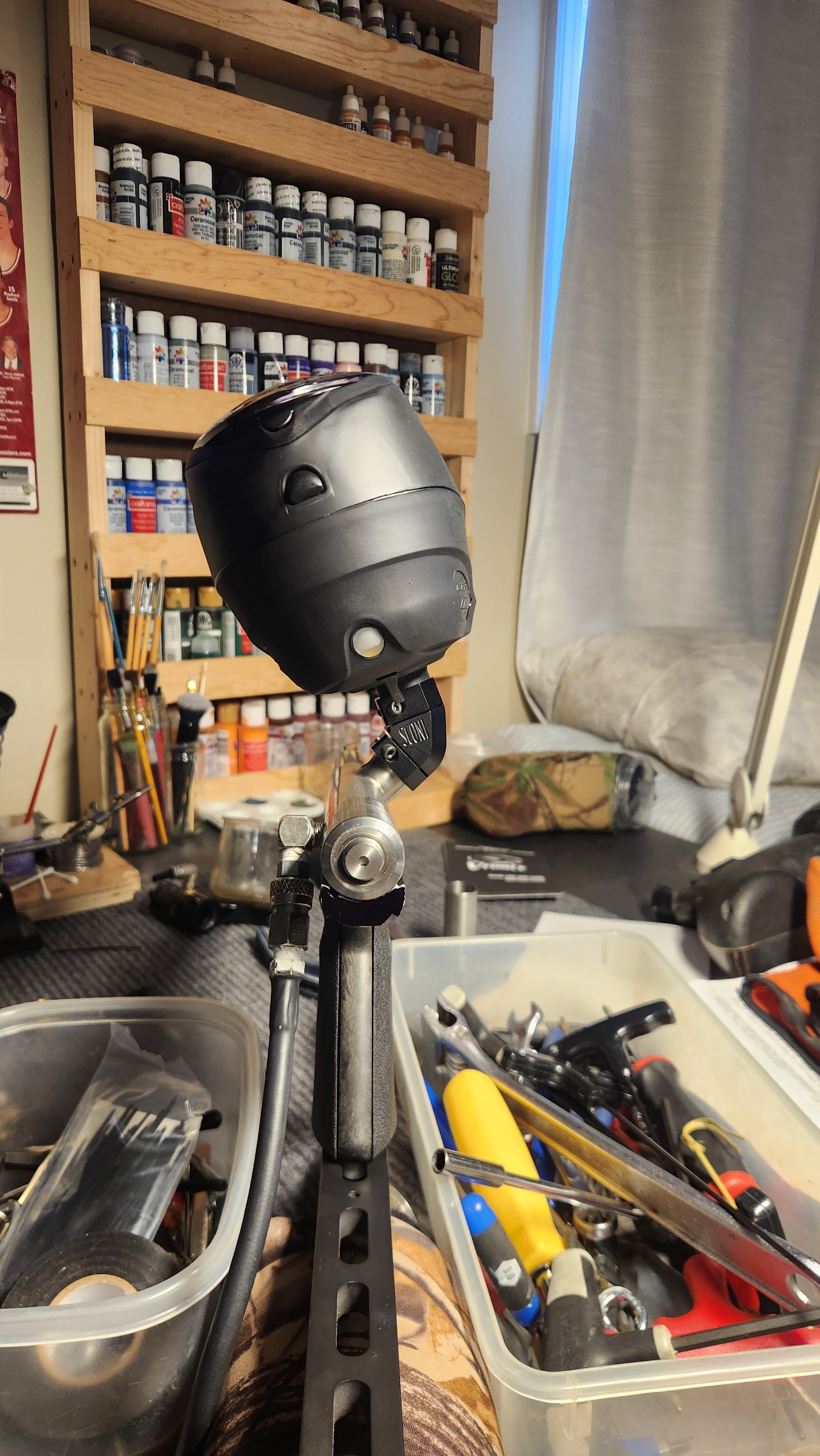

                  From last weekend, I can confirm that the LTR is fantastic with a centerfeed classic mag running a lvl 7 bolt with Doc's AC adapter.
                  I just put the LTR on my right feed classic with a lvl10 bolt and gold spring. This setup is using a sconi lean elbow and twistlock barrels with 3D printed TPU detents. I ran 150 rounds through a Dye Boomstick, and it ran every bit as flawless as the centerfeed setup did. I subsequently put on my RT stock barrel with double TPU detents to see if they gave the lvl 10 bolt any issues, and it also threw about 30 flawless balls rapidly. I'm pretty confident that the LTR is going to work perfectly with anything that isn't a powerfeed. I simply haven't tried it with one of my powerfeed bodies yet. Given how much I prefer the RF, it might be awhile. At the very least, I can definitively report that the sconi lean elbows work reliably with a force feed loader like the LTR or Rotor. It also places the center of gravity right over the centerline of the gun when loaded up. It seems to be the best of both worlds. I will be using the RF\sconi setup next time I play.
