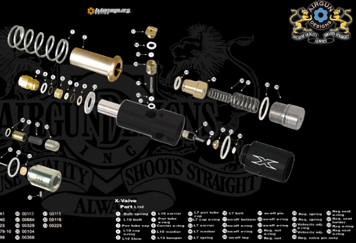

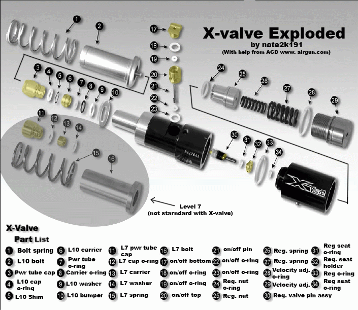

          superman Ah I see I made an error with the nomenclature. I thought for whatever reason you were talking about the reg valve pin assembly. Just to confirm I know what the heck is going on (sorry) are you referring to part 25 as the reg piston? I sent a picture of part 34 being stuck inside part 32 (attached to part 30) instead of sitting in it's seat on the back half of the valve

            This one is easier to see. Yes 25 is the reg piston. Thinking about it some more, I would definitely start with 31.

            Following up for anybody having issues in the future. The issue is my Regulator valve pin assembly (part 30 from the picture above). I swapped in an assembly from a working X-Valve and she shot perfect. There is a lot of play in my Classic RT's assembly which may be why the previous owner was running 3 o-rings instead of the washer and 2 o-rings. Who knows, I'm just going to bite the bullet and pay $30 for a new one.
