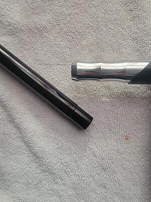

    Does anyone have experience fixing these? I purchased it like this and the previous owner said that Teflon tape was the way to fix it. That made no sense to me but maybe my beliefs are limited in the way of Teflon tape applications.

    Teflon is meant to make things NOT stick it's basically thread lubricant so you can torque fittings further.
    You'll want to use epoxy or something similar.
    Best way to get them to align is on lathe centers
    • Maxwell
      Maxwell commented
      Yea, I figured he either misspoke or I've been using Teflon tape the wrong way my whole life. I don't have lathe centers, so I'll probably just see what happens with the Epoxy and buy another Doc's if I cant figure it out.

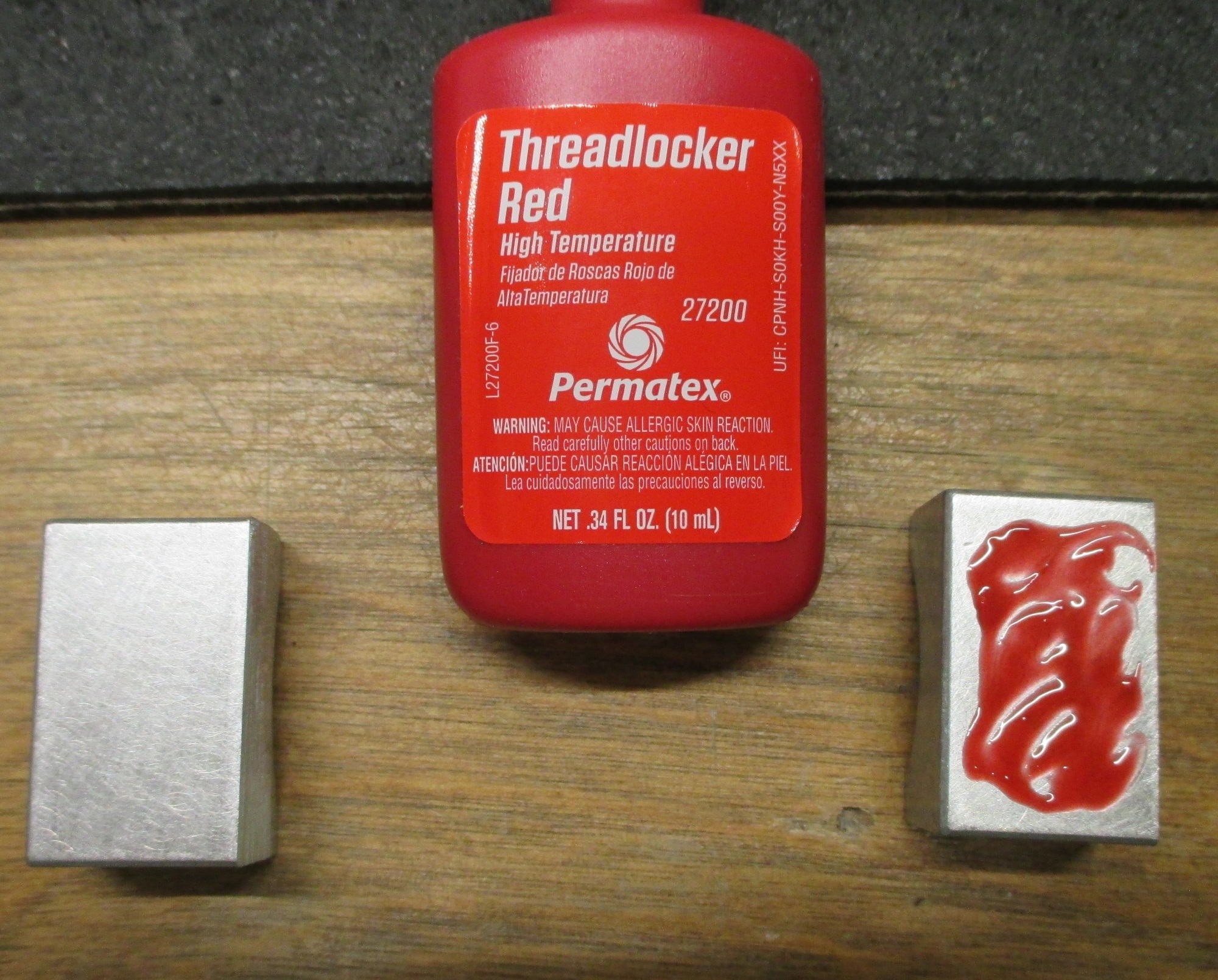

        Doing a test now, nothing fancy just gluing two flat pieces together with red loctite, I'll post finding tomorrow

        Nice. If I were a betting man, I'd guess that the shear strength is decent but it'll lift apart easily.
        Loctite will only harden when it’s in a sealed environment. It should work but there is a specific retaining type version of Loctite you can get that better.

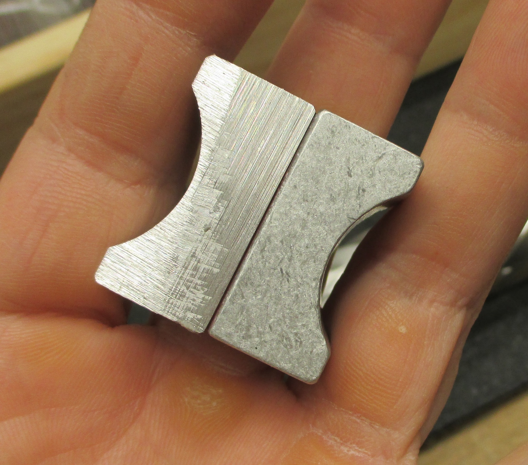

            Solid as a rock! I dropped it, tapped it on a vise, twisted and pulled, it didn't budge. IMG_8196.jpg IMG_8192.jpg
            • Maxwell
              Maxwell commented
              Thank you for the testing sir. I've got this on hand so here goes nothing.
