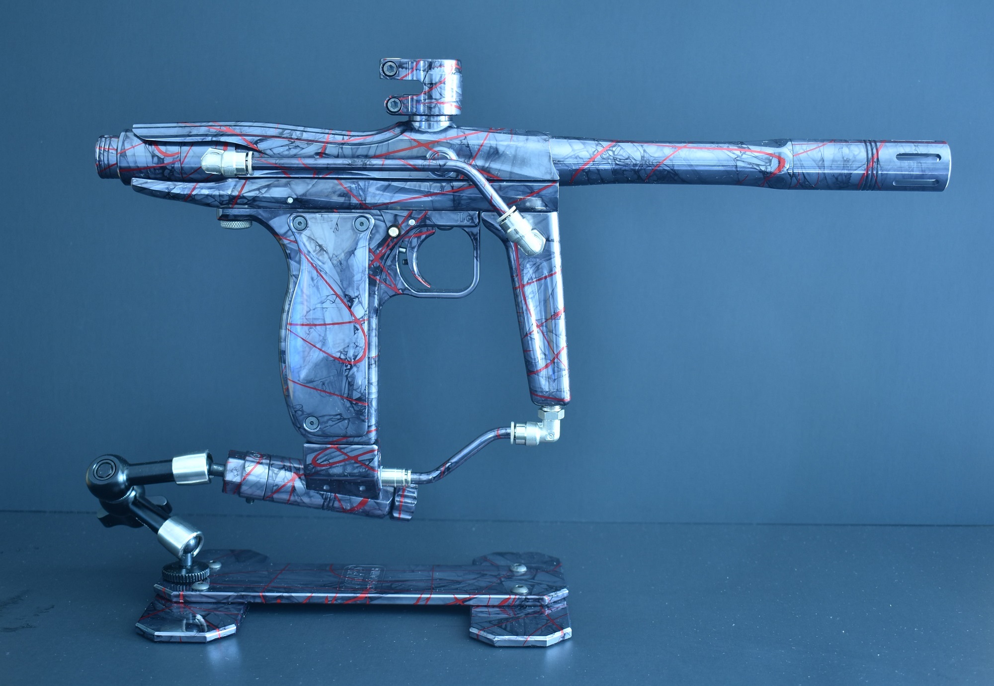

    Is it a mechanical or pneumag? lol

    • 1snowridr
      1snowridr commented
      It's pneumatic, I know because it has a side kick and no block off plate between that and the frame 😉

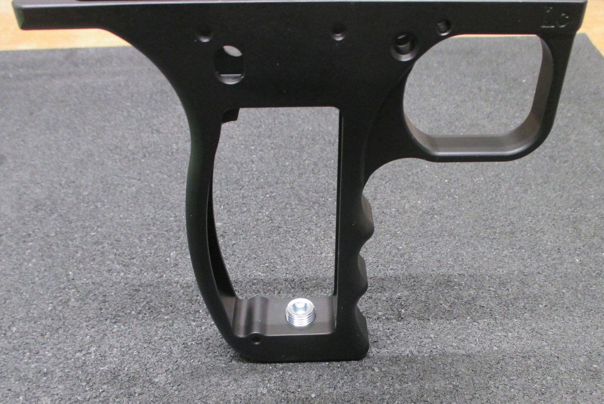

  • LukeAO
    lukescustoms.com
    • 172
    • Arizona
    On my frames you can just plug the LPR port so you can use the Sidekick and Micro Wedge with mechanical setups.

    • 1snowridr
      1snowridr commented
      Oh you tricky tricky!

        Can the LPR not “turn off” by just completely backing the adjustment screw out? Seems like that’d be easier than pulling the whole LPR out or having to install an intermediate blocking plate.
        (I’m not sure how your LPRs internals work, but the common family of small WGP LPRs can be “shut off” that way.)
        • LukeAO
          lukescustoms.com
          • 172
          • Arizona
          Sure, but not all people own the LPR but may still want to run my Sidekick, so that port needs to be blocked.
          That said my LPR's are designed to be installed in a grip frame so they are easy to install and remove. Plus with the oring seal you dont have to futz around with thread sealer..
