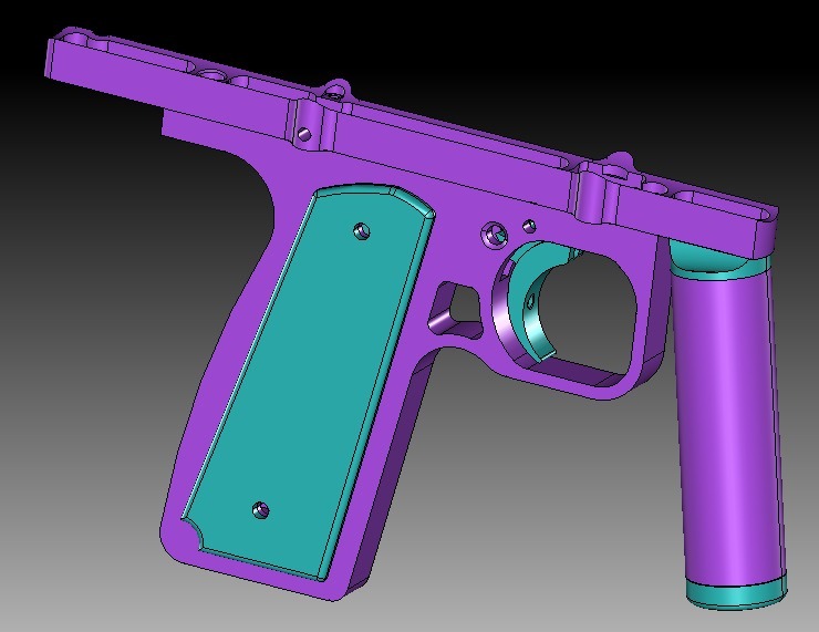

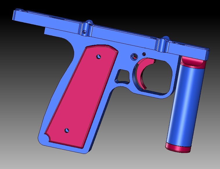

    I have three new potential products here. First is the 'M80 grip frame' same width as the AGD classic carbon fiber frame 1/2 inch. It uses my Intelli type single trigger with magnetic return. It's designed specifically for 45 ACP grip panels, I will not be making panels myself. This is a mechanical ONLY frame..... Project would also include my new 'Hybrid Extreme Rail' not an h2, thickness/height matches a classic Automag rail, main diameter is 1/2 wide to match the grip frame exactly. ULE milled and uses the RT sear.... Carbon fiber foregrip is similar to the others I offer, aluminum parts should come in at least 1/2 the weight as my others, ULE milled, though minor it all adds up. Angled and straight would be available........... Please ignore the sharp edges everything will of course come with chamfers and fillets to smooth everything over.

    I like the rail and foregrip. I personally don't like thin frames so the frame probably isn't for me. I can use a AGD cf frame because the grips on those are thick. Maybe I could find some thicker 45 panels

      I haven't decided if this will be sold A la carte or not. It wont be a huge run parts and I dont want to be stuck with misc parts that dont fit anything else. But who knows at this point, I'm just testing the waters to see if there's interest. Some of the ACP panels are fairly thick though. Or maybe do a preorder so I can get the numbers right, not sure right now...

    Another thought is I could design a set of panels that would mimic the classic and someone could print them(?)
    • StaticShocked
      StaticShocked commented
      That would probably work out well. People can either order them or print them themselves and use either hard plastic, polyurethane, or even wood. That would be pretty sweet.

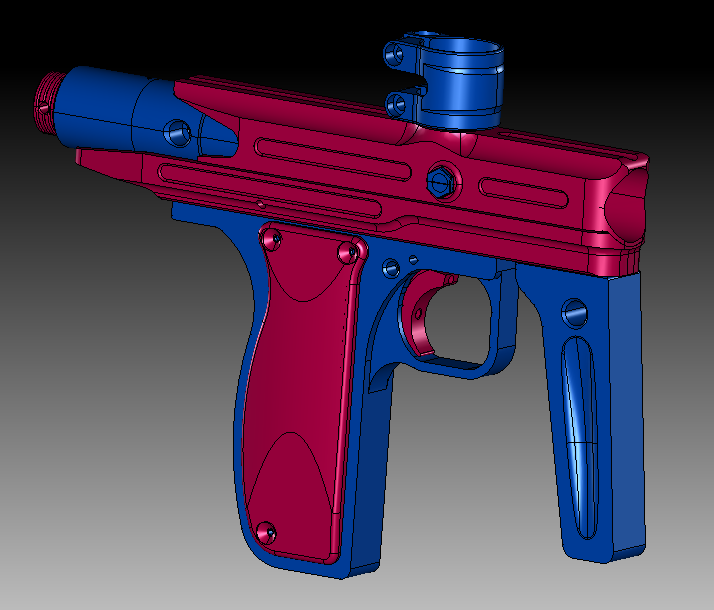

      Originally posted by Meglomachinist
      Pretty sexy man. That frame would look real good on the new body you were showing off. Which I still want...
      I dont know, the M90 grip frame is 1/2" wide without grips and the D3 main body and rail is 1.19" without detents.
      I think this combo looks better with a standard 3/4" thick MP90 grip frame.
      Really the ULE, XMT, Automag or Minimag bodies were the design consideration for these parts.
      I like the MP90s with the D3 much more

        Oooo that does look good thanks for posting that assembly helps me better picture it for if you do release those bodies and rails as a kit.
