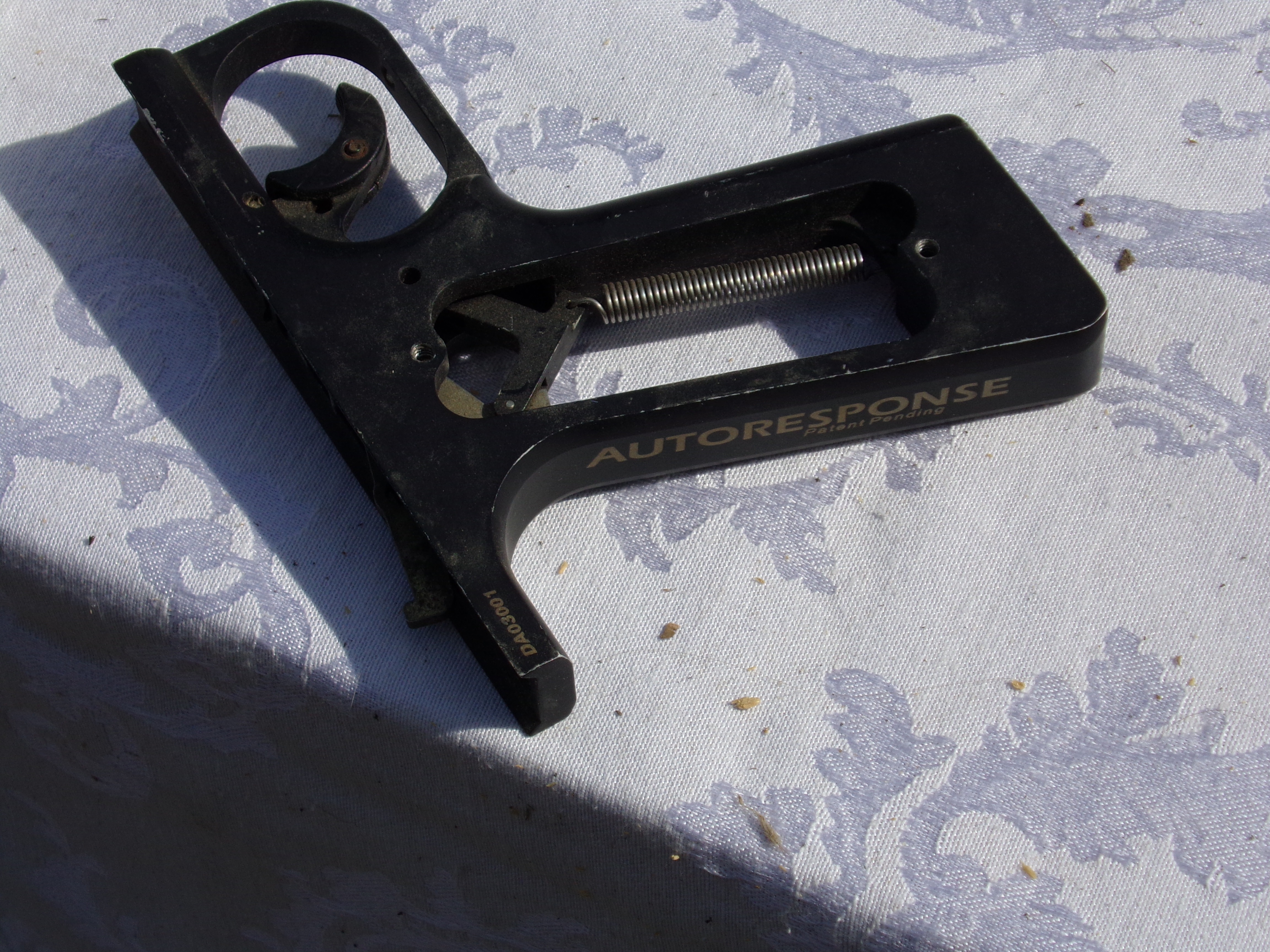

    For obvious reasons I need to make my X-Valved Mag shoot as fast as humanly possible. I found a comment in a different thread where a member said the RT effect comes down to o-rings being broken in, On/off pin length, air input pressure, bolt type, bolt spring type, and trigger frame geometry.
    I've got some broken in o-rings in the marker, a level 7 I can toss on with a fresh spring, and a regulator that can be adjusted to 900-1100psi. ​I also have a spare on/off pin. The main purpose of this thread is to ask if I'm going the right way about achieving this and how to properly trim down the on/off pin. Just sand it down on a belt sander little by little and keep testing a retesting it? I worry about flying to close to the sun in my quest for maximum performance and making it too short. Currently it won't RT at any input pressure.

    You can buy pins from AGD
    Red One
    • Maxwell
      Maxwell commented
      I see a .750. Is sanding one down not a good idea?
    • BLachance75
      BLachance75 commented
      Yeah you can sand it. Go slow, it doesn’t take much
    • Maxwell
      Maxwell commented
      Awesome, thank you.

    I second going slow with sanding the pins. I went slow knowing it doesn’t take much and I still almost took off too much.
    Not sure what asa you’re running but my RT wouldn’t RT at any pressure either. At the time I was using an older Taso I believe drop forward on/off combo deal. I swapped it out for a new CP on/off and it RT’d immediately.
