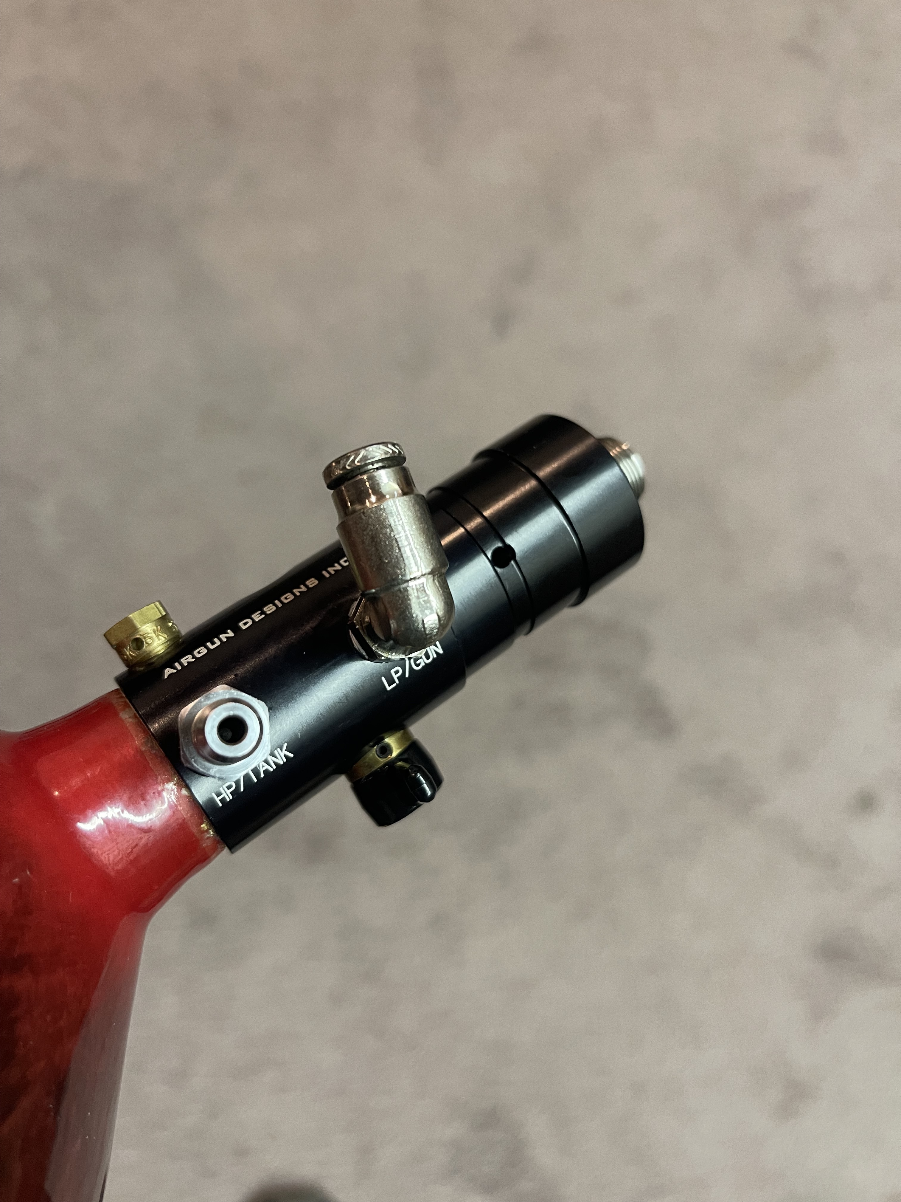

    Hey gang, recently acquired a Flatline 3k reg. Just rebuilt it with an AGD kit. Output pressure is set at 800. Got a steady leak out of the hole on the right side in front of the output to the marker. A little out of element with this one on what might be causing that?

    make sure you have the reg seat oring in correctly or swap it out with a known good one.

      Thanks Tuna! Had too small of an oring there, all good now.
