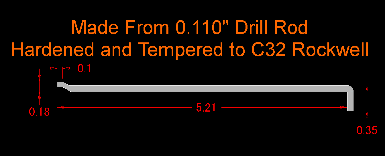

    I have no idea if Rainman used is own design but here is the AGD pump rod spec

      I believe his were 6-32 threaded on the end that attaches to the pump handle.

        Sounds like I'll be attempting to make one. I didn't think these were really things that people had just lying around, but I had to ask. Thanks for the specs, I'll report back with my success/failure!

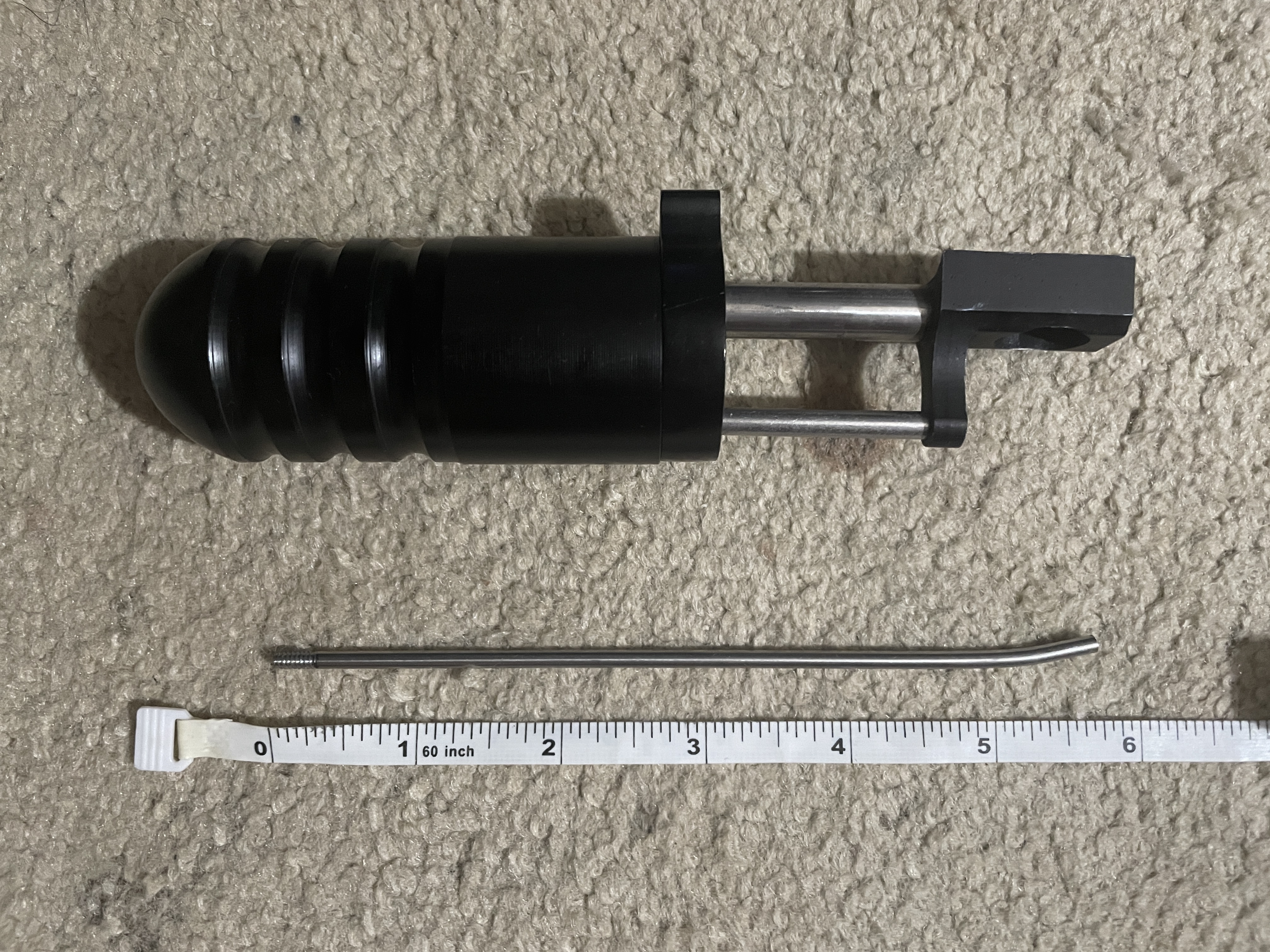

          Here we is a picture from mine. Hope this helps.
          My Collection
          • jpdgas
            jpdgas commented
            I wonder if there is any advantage of the bend in this one vs the kink in AGDs. Maybe I'll try both
