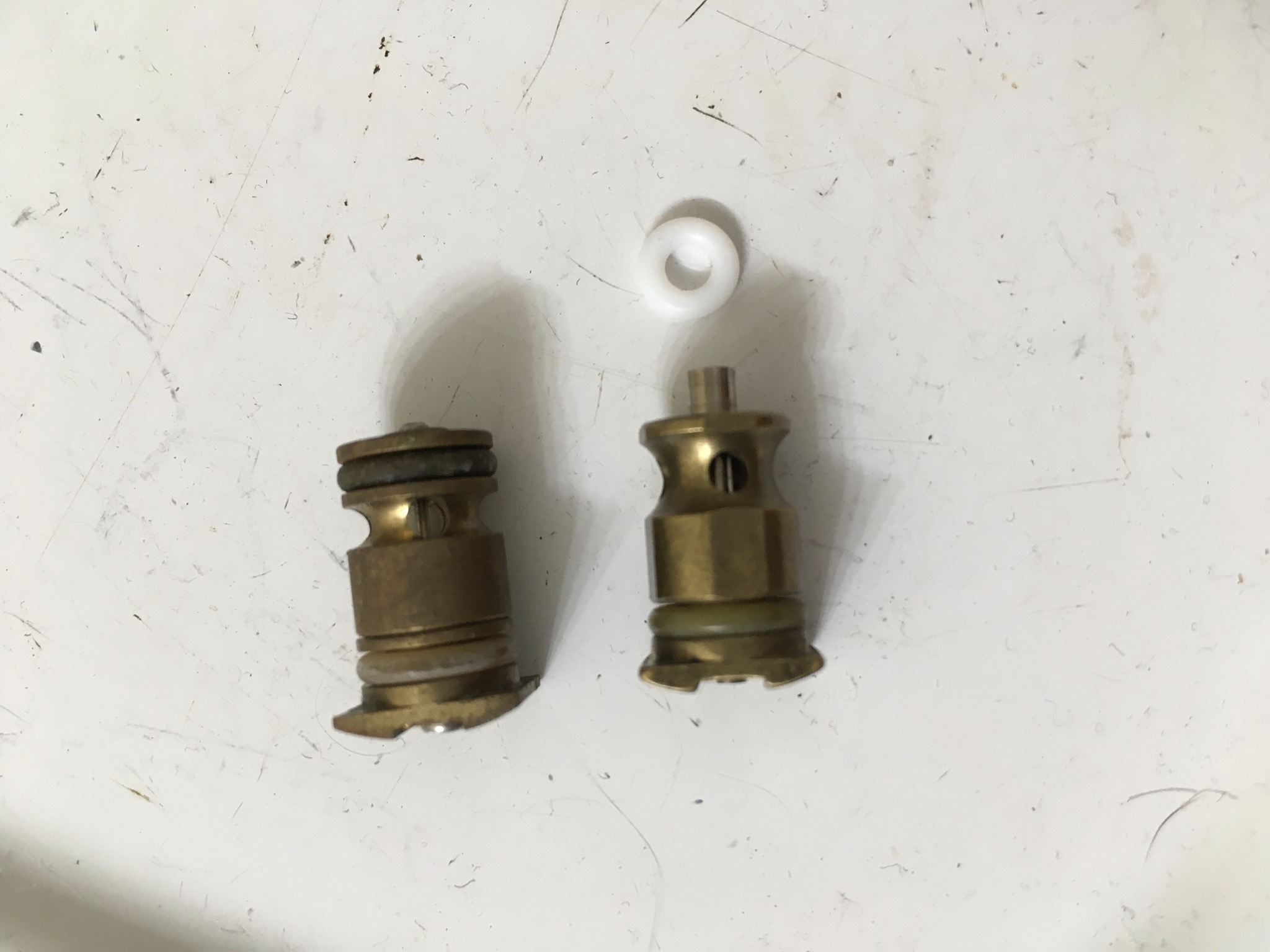

    I have these and am wondering what the difference is between them? I'd like to get one in a 'mag I'm building.

    Left is a ult.
    right is an rt on/off.

      I appreciate it. Thank you.
      Is the RT on/off complete? Does the teflon 'ring go at the top?

        Yes. Put the teflon oring on the pin and a powertube oring down in the valve hole then pop it in. If you arent using it in an automag and CO2 replace that teflon oring with a urethane one Those orings look terrible and I would replace them for sure.

          Originally posted by scottieb
          I'm wondering what the difference is between them?
          What makes them 'different' boils down to pin diameters and oring sizes, both of which dictate it's performance one way or another
