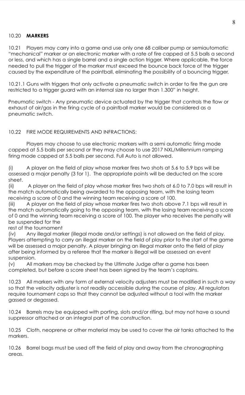

    ICC rules are pretty standard.
    • ChoSanJuan
      ChoSanJuan commented
      10.21.1 is pretty universal with a ton of rulesets that I've run into with NXL, ICPL, WCPL, etc... Best to just keep this rule until you find out otherwise

    ICPL Rules 2025 5v5 and 10v10
    6.4 MECHANICAL MARKERS
    6.4.1. A marker with no electronic components
    6.4.1.1. Shall not fire more than one shot per press and release of the trigger.
    6.4.1.2.Shall only fire a shot when the trigger is pressed.
    6.4.1.3. Shall not increase or decrease the force required to pull or hold the trigger to or at any position without the use of tools (“reactive trigger”, “pneumatic trigger assists”).
    6.4.2. Markers with triggers that only activate a pneumatic switch in order to fire the marker are restricted to a trigger guard with an internal size no larger than 1.400” in height. 6.4.3. Markers with triggers that only activate a pneumatic switch in order to fire the marker are restricted to a trigger that is no wider than the narrowest part of the original manufacturers trigger guard and does not protrude outside of the original manufactures trigger guard at any point
    6.4.3.1. Pneumatic switch - Any pneumatic device actuated by the trigger that controls the flow or exhaust of air/gas in the firing cycle of a paintball marker would be considered as a pneumatic switch.
    6.4.4. “Beaver tails” must be in place on any ‘Autococker’ based markers that use a cocking rod.
    6.4.5. A pump marker may only be manually re-cocked between each shot, thus allowing for the hammer to reset.
    6.4.5.1. This pump action must consist of one complete backward (pull) and return forward (push) cycle of the pump mechanism.
    6.4.6. The trigger may consist of one of two types:
    (a) A standard trigger that requires a pull and release for each pump cycle.
    (b) An auto-trigger, which consists of a trigger that can be held in the ‘pull’ position while cycling the pump mechanism.
    NXL RULES 3v3, 5v5, 7v7, 10v10, Classic/ Pump 2025
    7.3 MARKER (CLASSIC DIVISION)
    7.3.1. A marker with no electronic components
    7.3.1.1. Shall not fire more than one shot per press and release of the trigger.
    7.3.1.2. Shall only fire a shot when the trigger is pressed.
    7.3.1.3. Shall not increase or decrease the force required to pull or hold the trigger to or at any position without the use of tools (“reactive trigger”, “pneumatic trigger assists”).
    7.3.2. Guns with triggers that only activate a pneumatic switch in order to fire the gun are restricted to a trigger guard with an internal size no larger than 1.300” in height.
    7.3.2.1. Pneumatic switch - Any pneumatic device actuated by the trigger that controls the flow or exhaust of air/gas in the firing cycle of a paintball marker would be considered as a pneumatic switch.
    7.3.3. “Beaver tails” must be in place on any ‘Autococker’ based markers that use a cocking rod.
    7.3.4. A pump marker may only be manually re-cocked between each shot, thus allowing for the hammer to reset.
    7.3.4.1. This pump action must consist of one complete backward (pull) and return forward (push) cycle of the pump mechanism.
    7.3.5. The trigger may consist of one of two types:
