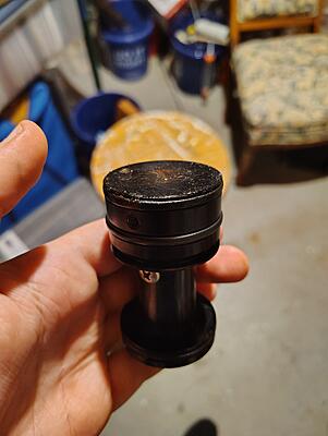

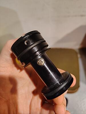

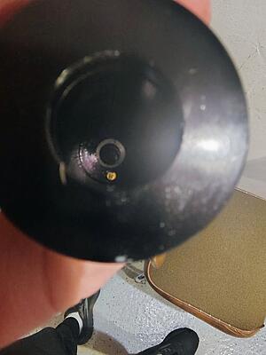

    Nova 700 regulator body has been... customized...
    I really don't know what to make of this, it seems like someone plugged the original air pathway with a Philips head screw, then epoxied a grub screw into the other side? When I took it apart it was also missing the cup seal, cup seal cup and the spring that goes behind that, so maybe they tried to just bypass the regulator entirely? This really doesn't make sense to me. I can get better pictures tomorrow if anyone is curious.

    Maybe to run a separate regulator? Not sure why you would need to do all this though

      Trbo323 right? I opened this up thinking it would need a new cup seal and found this mess. The ASA setup is still the same so I'm not sure how they'd get a different regulator on there, and since there's a ton of pressure going through the system, the 150psi overpressure valve immediately goes off and just vents all of the air anyways

        Pretty sure these were done by nova. I know i had one that was similar.

          Any recommendations for getting some kind of working regulator on this?
