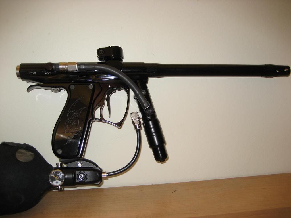

      For example, here’s a Palmer’s Fatty stealthily acting as an LPR for the hidden pneumatics:
ID:	775032 Click image for larger version

        You can always do the lpr this way. Seen a couple great looking sleeper classic pneumags done like this. They just wrap it up in foam. Only see the lpr hose in very closer look.

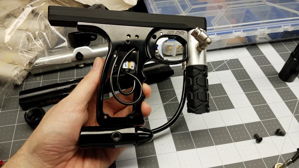

          KnowNothingMag made a Troll LPR Foregrip a while back. Similar idea to what you're thinking.
          https://www.automags.org/forums/show...ighlight=troll
          He's not really in the game much anymore but his foregrips are still around some. I have one sitting on a prototype gun for fitment checking and LPR usage for a Pneumag drop in ready application. ​

          Someone correct me if I am wrong in remembering this. But some I think took CP inline regulator and tapped the inside for the lpr hose. You would not see the hose running inside the rail into the regulator. Again could be thinking some different.
          you can also go with Luke battery pack adapter. The adapter replaced the top of the battery pack, hides the hose going into the battery pack to the lpr also hiding inside. I have some of those.
