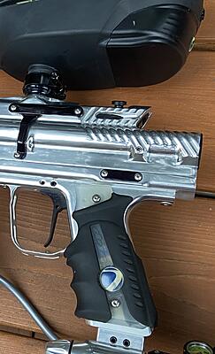

    Anybody making boards for these anymore? Trying to revive one I found buried in my shop.
