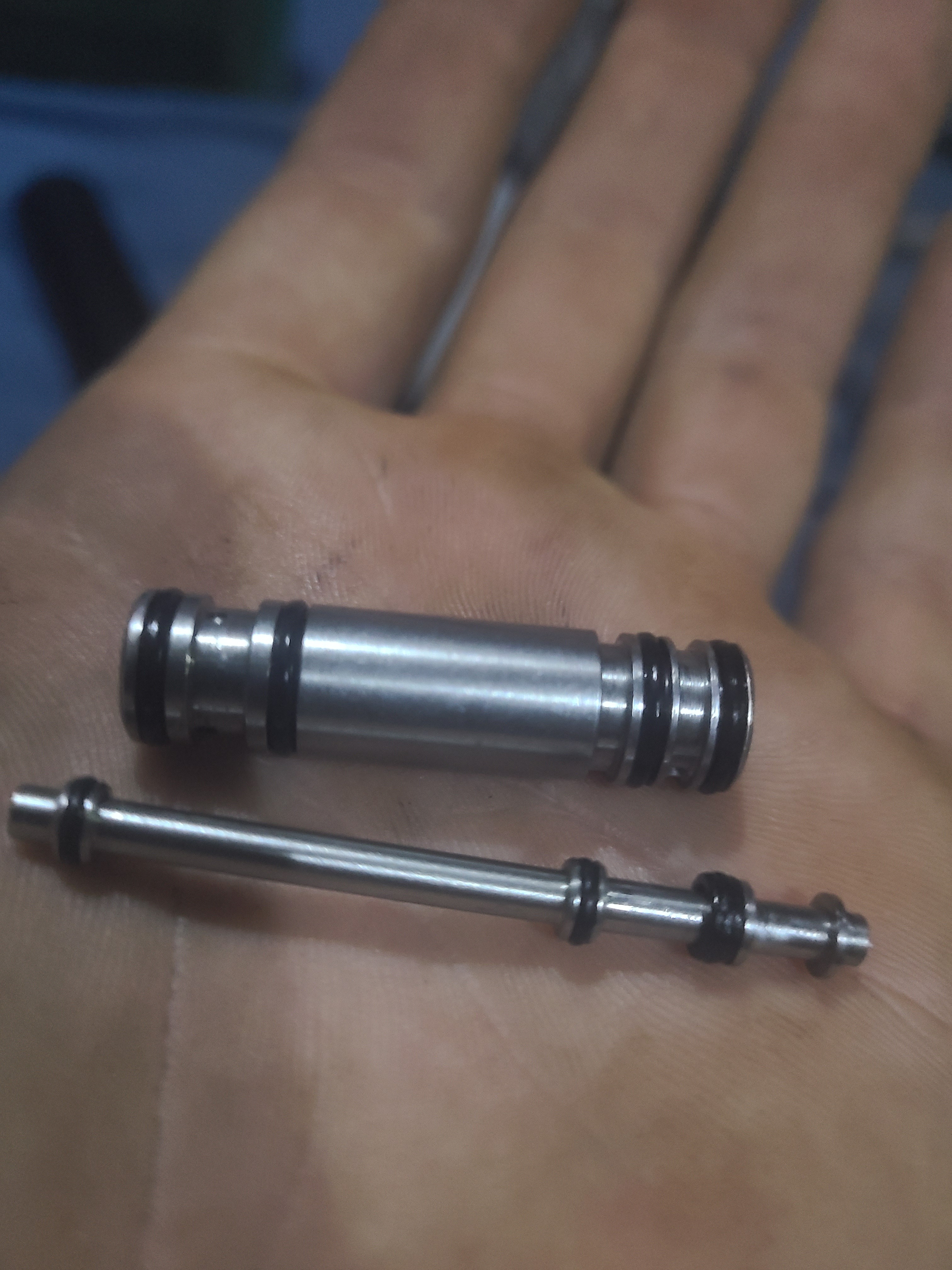

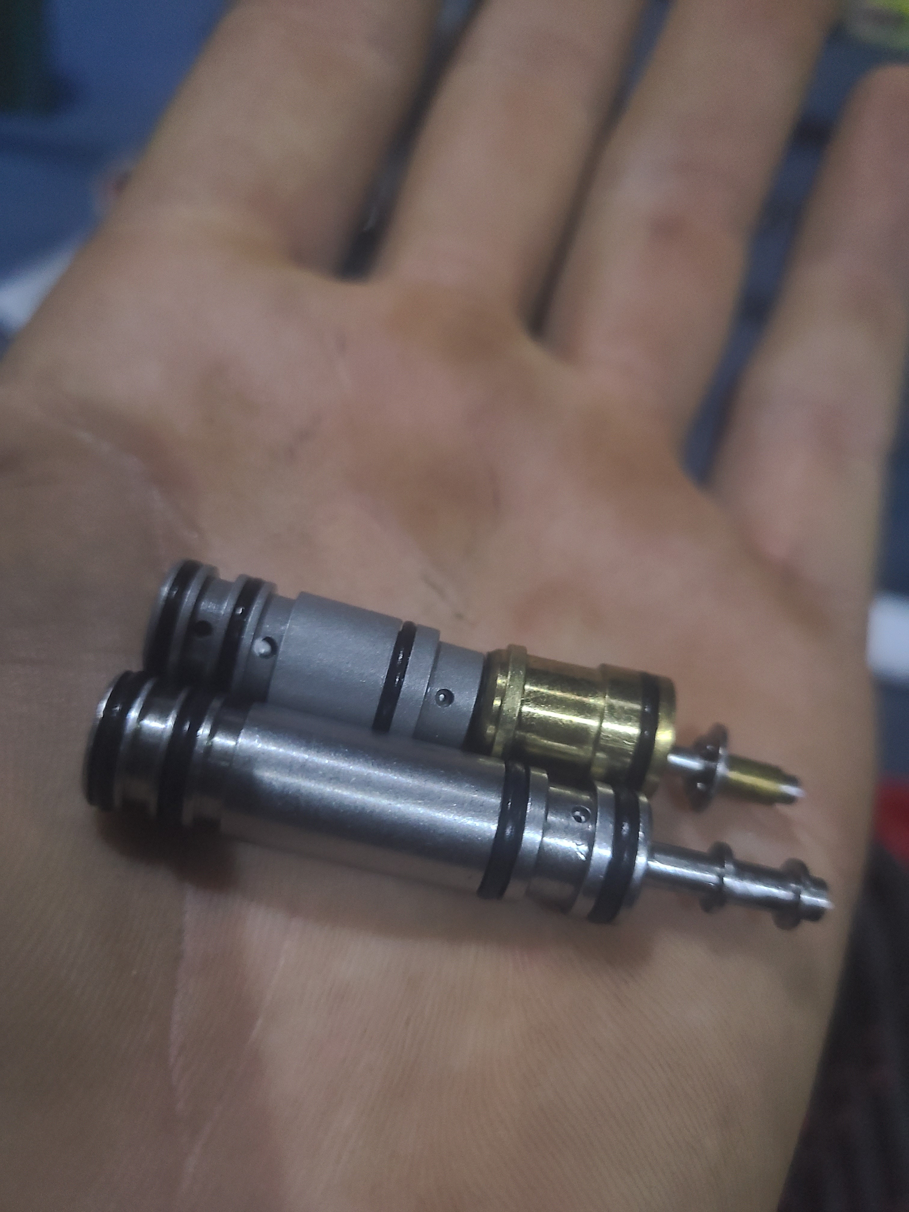

    Any one know which one is the newer or older version of the 3 way?
    Frenchy is here!
    • 3019
    • Nor Cal

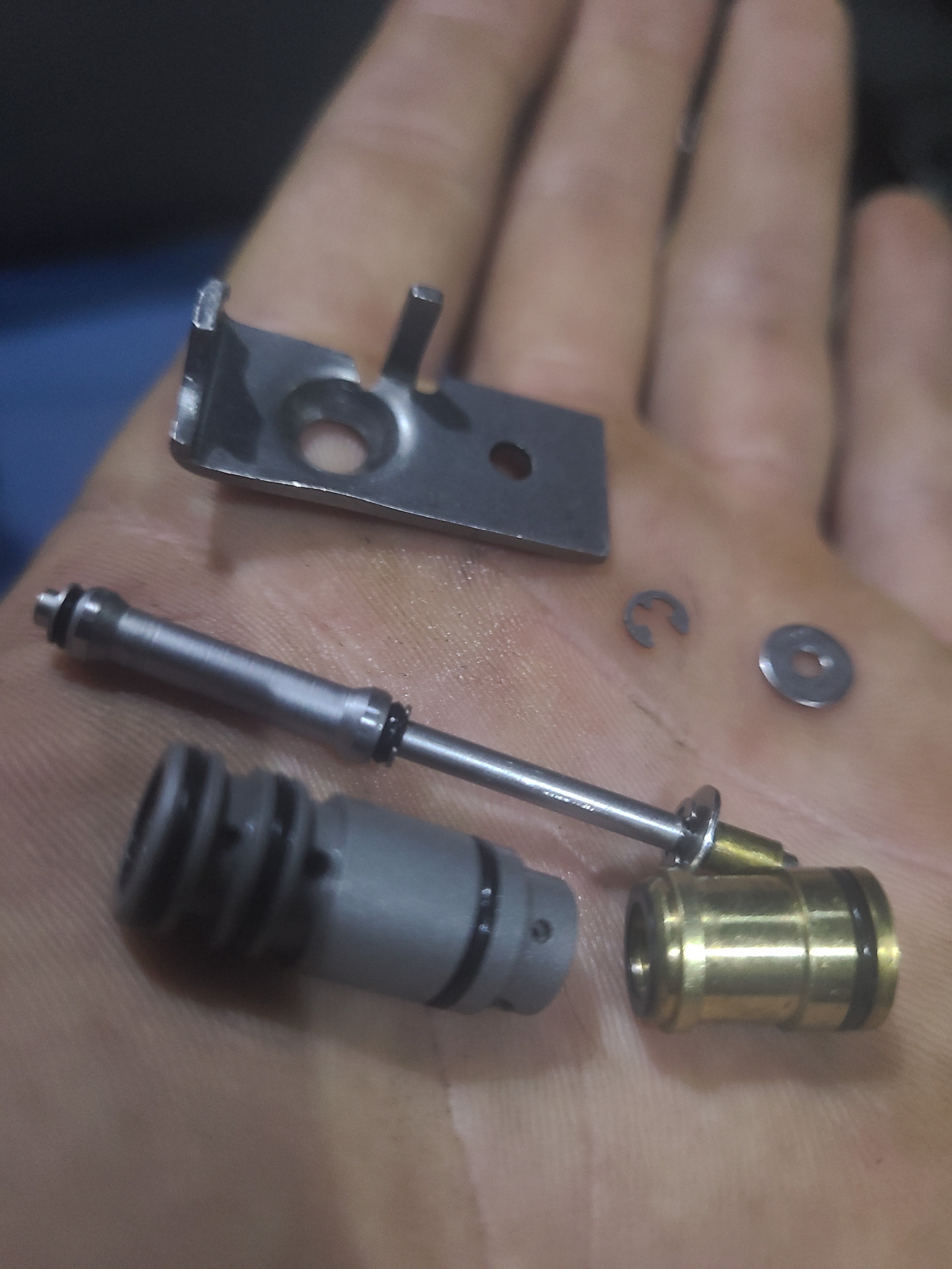

    the 2 piece one with the brass is the CO2 version, the all steel is the HPA one
    • Snowpuff
      Snowpuff commented
      That c02 version has that brass filter in the asa, does that reduce incoming flow from the regof the bottle??? I noticed things with that brass filter will shoot low unless they use c02. What do you think?.
    Frenchy is here!
    • 3019
    • Nor Cal
    It will reduce flow for successive shot, but the low velocity on first shot is because the valve volume is too small.
    I bored out one and im getting good results, but its a tight space to carve out metal ...
