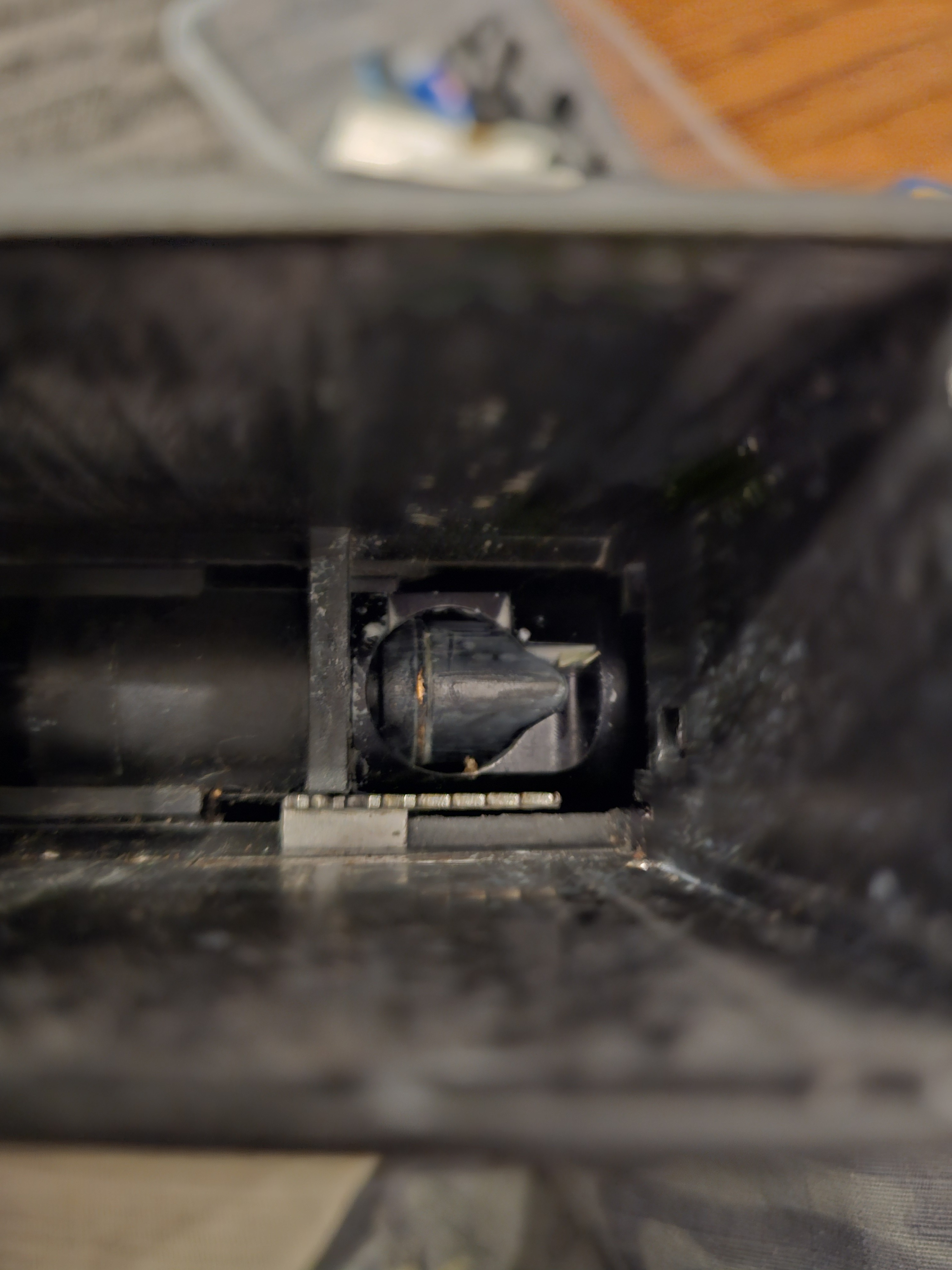

ID:	727593 Apparently my may got pushed up to high i to my breech and hooked around it? It was never stuck via latch apparently.
              You can see a broken portion of the mag stuck in. The breech.
              Now how do I prevent it from. Happening again?
              Last edited by Chemical-x.....ahain; 08-22-2025, 09:11 PM. Reason: Additional info
              • zenmic
                • 93
                • Plano, TX by way of Pasadena, CA by way of Memphis, TN
                It has been a while, but looks like your bolt shroud is not aligned, and has pinched the bolt head cover. Does the bolt cycle?
