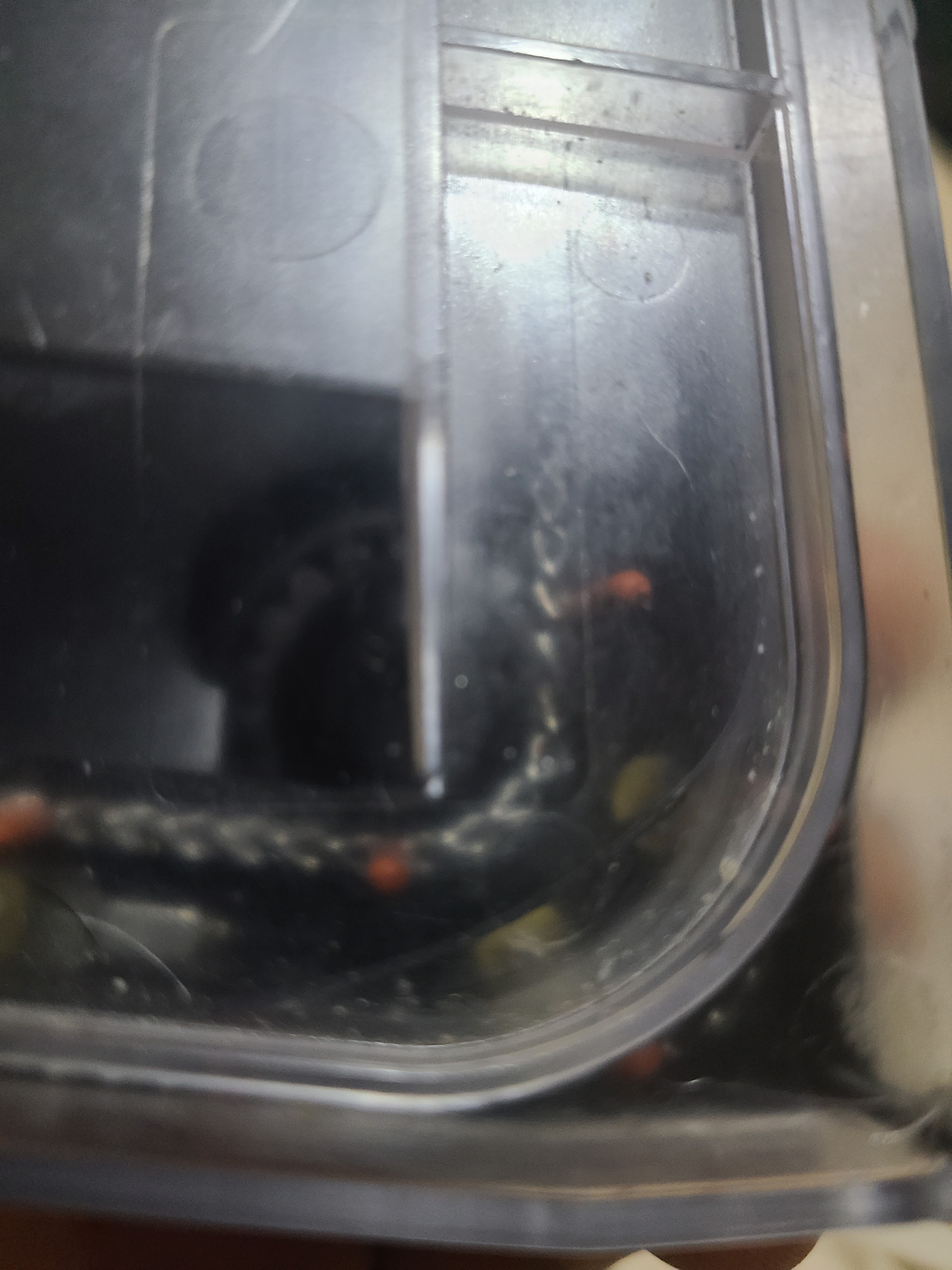

      Those mag shims work wow , I like to use the first gen mags because they don't have the fins on the crank which allows 3 slots for paintballs to fall into instead of 2 slots if you have a mag with fins on crank.
      However the first gen mags will bind and jam the mag , but if you use the shim like this amd creat a bit of a gap that will never happen because it off sets the balls enough , however instead of jamming, now it is slightly prone to blank firing but not nearly enough as if you were to use the mags with the fins on crank. I tested 80 rounds and only 2 blanks compared to the newer mags with the find on crank you will always shoot blanks
      Look at the picture that gap with the black shim has to be exactly like that almost so that when thr fingers travel they almost rub up against it on the bend .

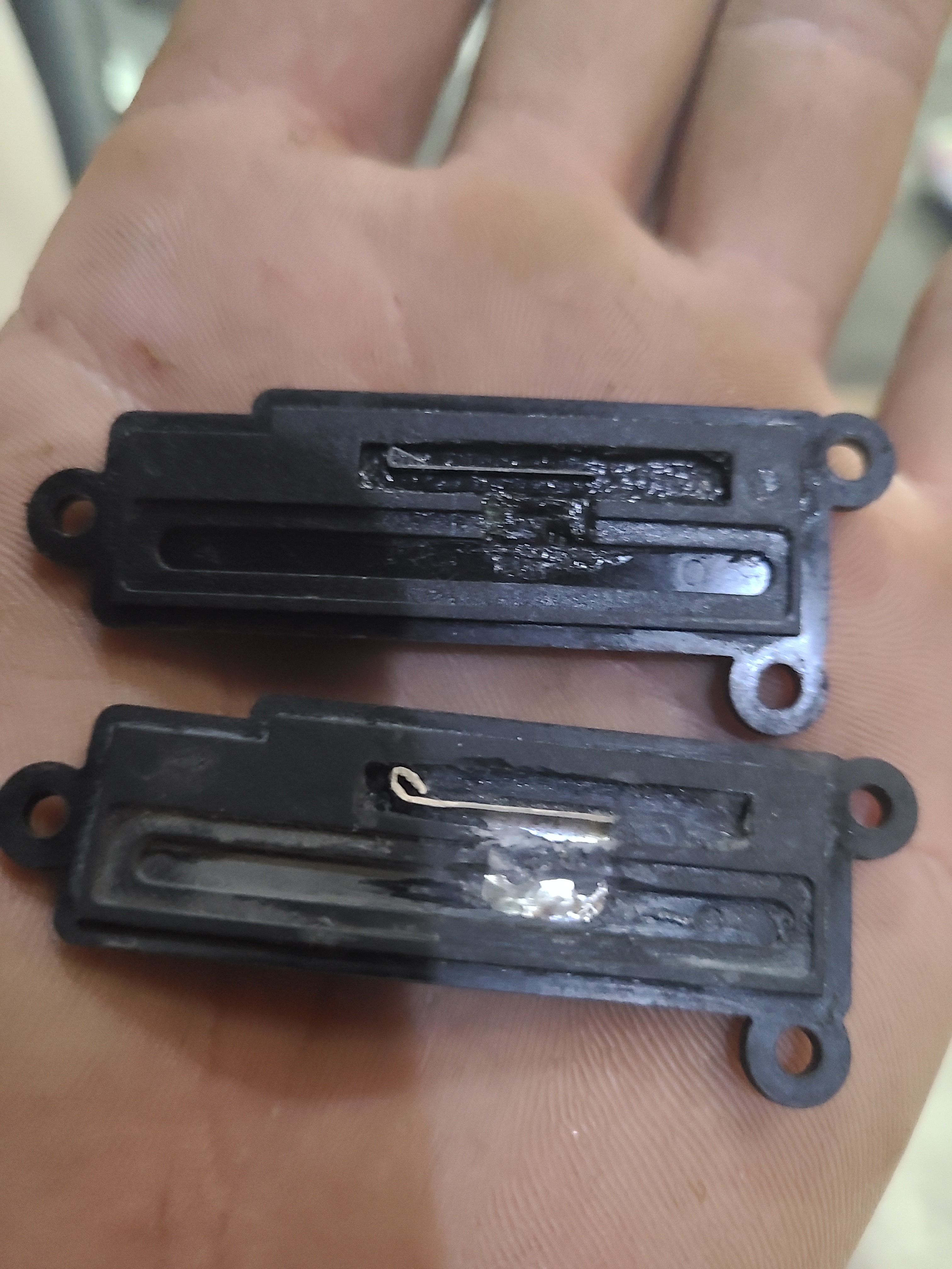

        #19
        I have successfully made the leaf spring 2 times now.
        when making making these keep in mind that the gap must be 1.5-2mm on thr top left for the pin to travel past the leaf spring .

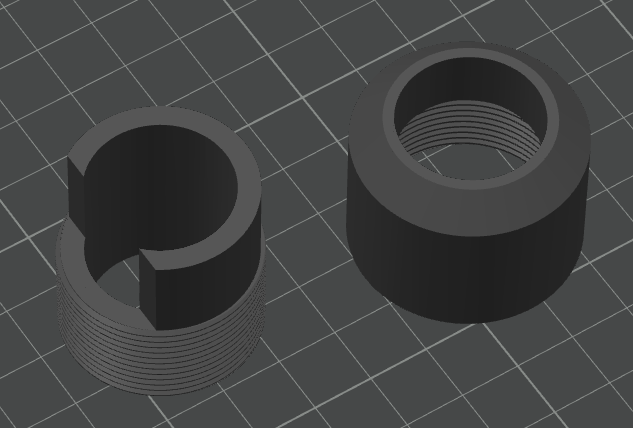

          here is a little something I have been working on. haven't got all the dimensions right yet, so test it out to see what I need to do to improve on it.
          the adaptor will allow you to mount a ar15 handguard to your ATS. then the cap is to have it look like a AT-10.​
