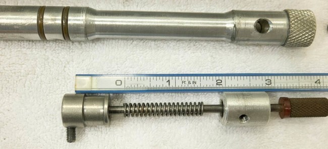

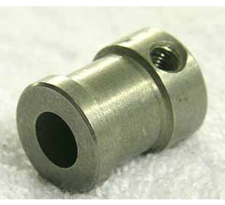

              Pic of a Sheridan style hammer (from Bacci)
              Click image for larger version  Name:	?u=https%3A%2F%2Fwww.baccipaintball.com%2Fmedia%2Fcatalog%2Fproduct%2Fcache%2F1%2Fimage%2F440x400%2F9df78eab33525d08d6e5fb8d27136e95%2Fa%2Fu%2Faut1267.jpg&f=1&nofb=1.jpg Views:	0 Size:	28.5 KB ID:	119646
              Click image for larger version  Name:	?u=http%3A%2F%2Fwww.baccipaintball.com%2Fwordpress%2Fwp-content%2Fuploads%2F2014%2F09%2Fnavarone-measurements-04-650x297.jpg&f=1&nofb=1.jpg Views:	0 Size:	52.0 KB ID:	119647
