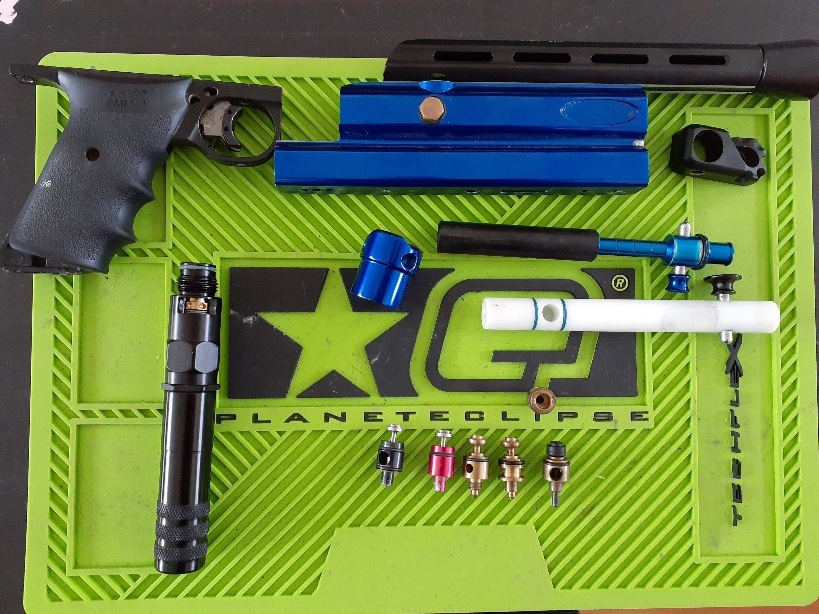

    I am building a stock class cocker and I am wondering what valve would give me the best result?
    I bough an unfinished stock class cocker project here some time ago and I am trying to figure out which internal to use
    Here are the parts list
    2k cocker body with phantom one piece feed
    PPS 12g bucket charger with adjustable regulator

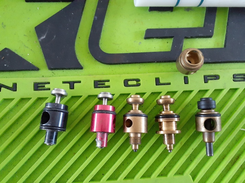

    I search my bins to see what valve I would have for this project and I found several. Instead of trying all of them I would like your opinions on which one would be the best choice
    ANS, RAT, sheridan palmer, Palmer?, stock 2k (and the other valve body over have a wider entry port and I think the stock cup seal would work with it)
    Note: the sheridan valve was installed when I bough the project, anyone tried sheridan valve in cocker?
    for spring I have inception kit and a New Maddman kit, any suggestion for valve spring? And recommended starting pressure for the reg?

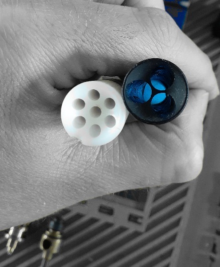

    For the bolt I would assume the smaller bore of the white delrin bolt would be better than the shocktech supperfly? Or you think the opposite?

    I mean, I'm not a stock class guy but I imagine efficiency is important so if try that black valve on the left to start. Twin rings and a large port should help in theory. For the bolts, try them both, those are super easy to change out

      I would think the orings on the bolt would make a bigger difference than the bolt face, so the white one may be better. But if both have the same orings the test to see. I did some testing on ID bolts and found the newer trident bolt had bumped my FPS up by 10+ with all things equal. Just test with a chrono and switch the bolts out to see which give better results.

        I run a palmers HP valve on my Scout. It works the best from what I have found.

          I ran a stock WGP valve at 500ish psi on a Sniper3 build and got 40 shots per 12 gram, with velocity at 260-270 FPS.
          Stock WGP valves are great, and with the extra volume you'll have with the 2k body, you can run lower input pressures and will likely get a similar or better shot count.

          Palmers or stock WGP

                  I have spent hours testing an tuning my sniper for super smooth operation. I ended up with a RAT valve, Maggot SLPS spring kit, CCM heavy hammer, and a bolt like the white one you have. I'm currently at 260-280psi with IVG about 1.5-2 turns in from flush getting 280fps and about 250-300 shots on a 13/3000 pending weather and fill method.
                  Interesting enough, the bolt has a big impact on the performance. Dual orings and a single directional port hole at the valve opening really allows the most air to get transferred behind the ball.

                      LP valves really shouldn't run over 300psi, and can be difficult to get to work at that psi. The face of the cupseal is so broad that the air behind it pushes against it and helps keep it closed. Hence why they have to run LP. If 400psi is what you're thinking, use a stock valve or the Palmers and stay away from the ANS and RAT.
                      I use to have a BM with stock lowers except springs and it ran really well and that's where I recommend starting.

                        Looks like that 12gram changer is regulated so you can run whatever you like and many have found regulated 12gram setups to have better efficiency.
                        I would start with the stock WGP valve and standard balanced spring setup like SLPS or green/green maddmann springs and see where that gets you. Pressure around 400 and minimal valve fart and then around 30 shots would be a nice target to have. Don't worry about venting if you don't cock the gun, just cock it before gassing it up.
