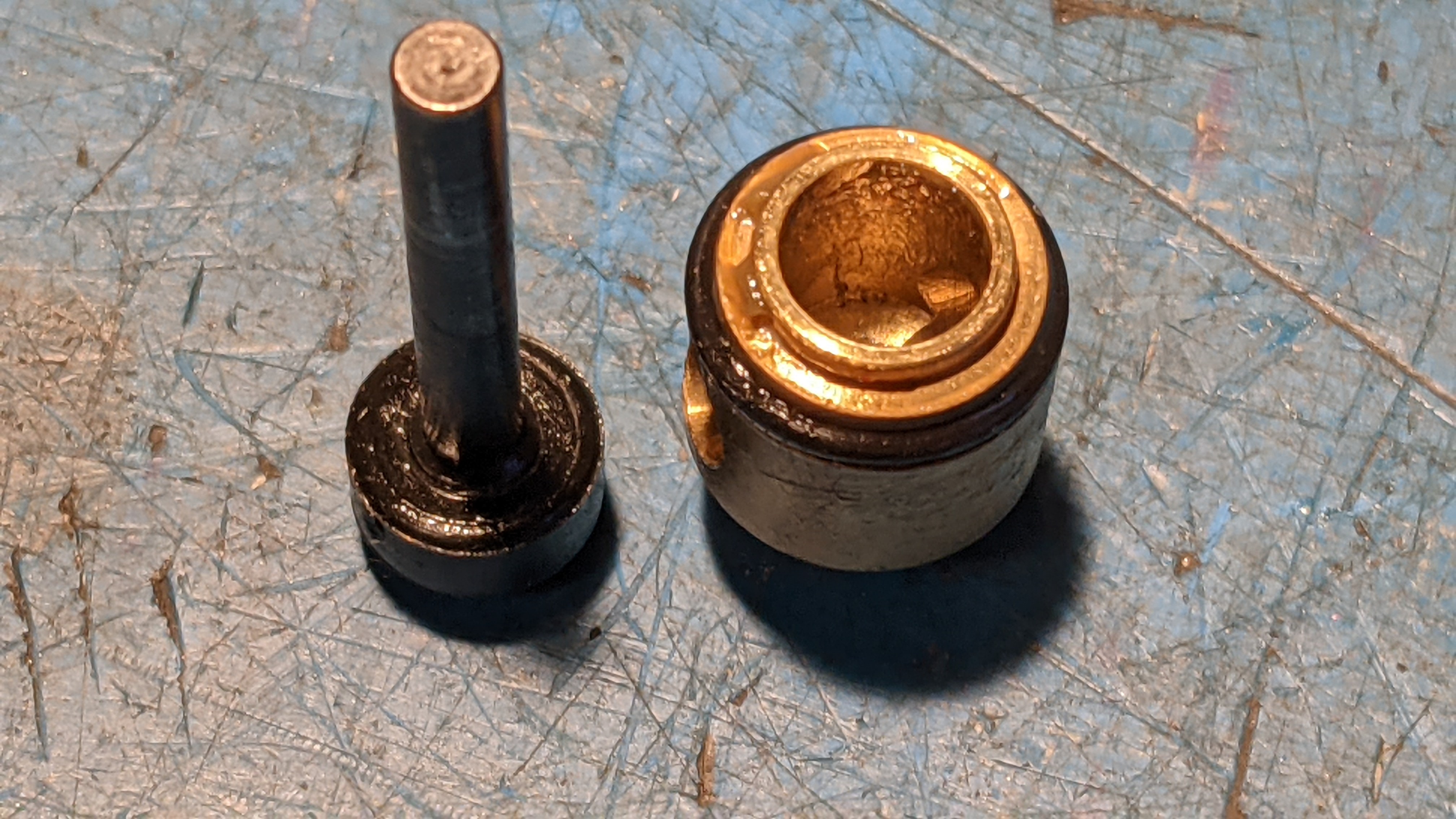

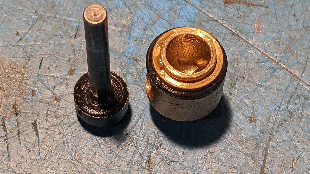

          Originally posted by Jordan
          What valve do you have in it?
          Some cupseal materials lose their "memory" and need to be left under air pressure for a while to seat properly, too.
          No idea ... I'm not a cocker guy 😅
          might make a delrin seal if this one doesn't work ...
          • OpusX
            OpusX commented
            ewwww looks greasy. clean that up and use oil.
            XEMON commented
            I threw oil inside the valve in the hope of sealing it before opening it ...
            I'll clean it up before closing it and throwing a 12g in.
            It's a pump build so it shouldn't hurt too bad.
          I. Am. Canadian. 🇨🇦
          • 3511
          Looks like stock 2k+. They're good valves but don't seal up at 100psi.
          Like the others have suggested, try a higher input pressure if possible. Start at 300psi, maybe.
          • Grendel
            • 1980
            • Lexington, SC
            Yup, clean it up, replace the valve body o-ring, lightly oil (Synthetic Pneumatic tool oil) and reassemble. Stock WGP valves work great down to about 250 psi below that you have to get creative with the springs to keep them sealed. There should never be grease in a Cocker valve train and that is either grease or old congealed oil.

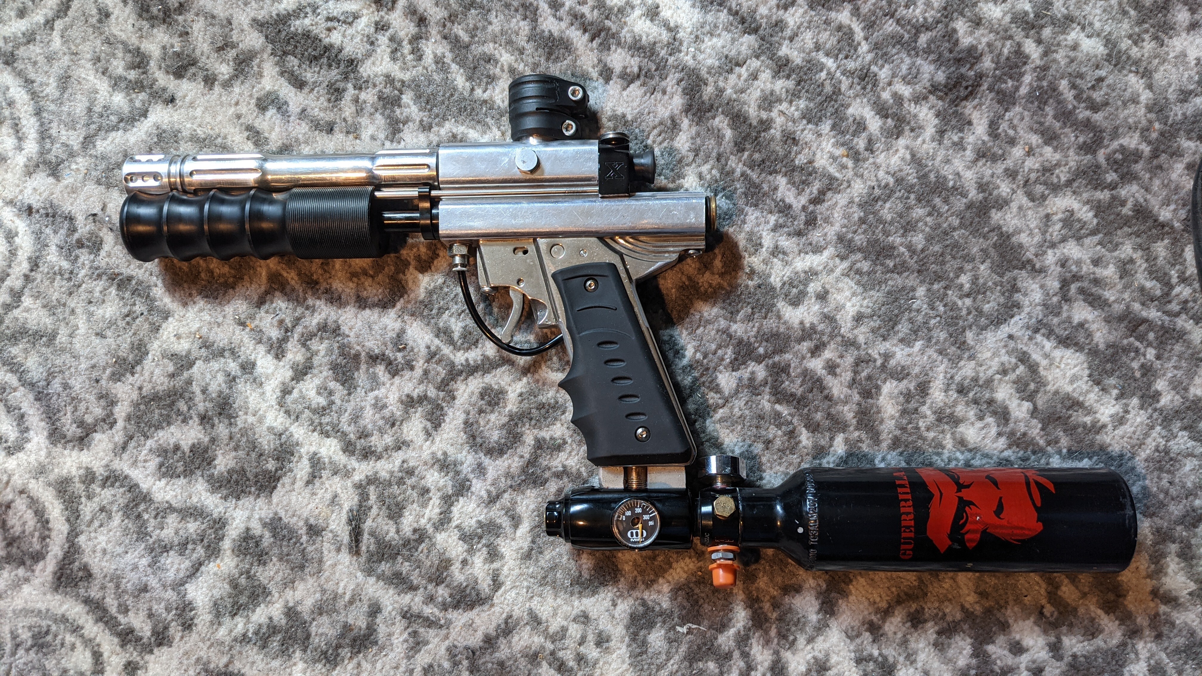

              it's a half block midget pump with air through frame.
              Am I the only one that want to see a picture of that custom cocker?

                    Little update:
                    Cleaned the grease off, put it back together and BAM! It shoot!
                    Found 2 other small leak, but got them fixed up really fast and now it seal nice and good.
                    Thanks for everyone's help for my first cocker build. I put it on the scale and it comes up to 1.245Kg
                    light and compact, it may even take me away from my sheridans.

                      Originally posted by Alexndl
                      So.... we have been waiting enough?
                      pictures?
                      Ok ... Here it is (with a 13Ci) ...
                      I can make a build thread with before and after if people want to ...
ID:	125291(PS: yes, the gauge is shot, I need to replace it ...)
                        Cdn_Cuda commented
                        It’s so tiny!
                      • OpusX
                        OpusX commented
                        Chopped hingy with a gas through mod inspired by a tippy pro-lite?! Such MCB!
                        XEMON commented
                        Always wanted an air through frame (nearly bought a pre-made one) then came across the midget and saw this ...
                        Just bought a stainless tube to replace the flexible line ... The flop is terrible ...
                        Originally played with the pump assist kit, but it doesn't stop leaking ... No matter what I do ...
                        So got this pump kit and it matches the barrel length perfectly ...
