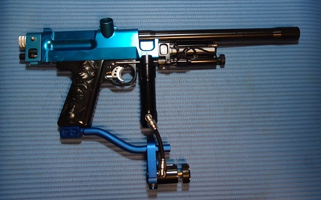

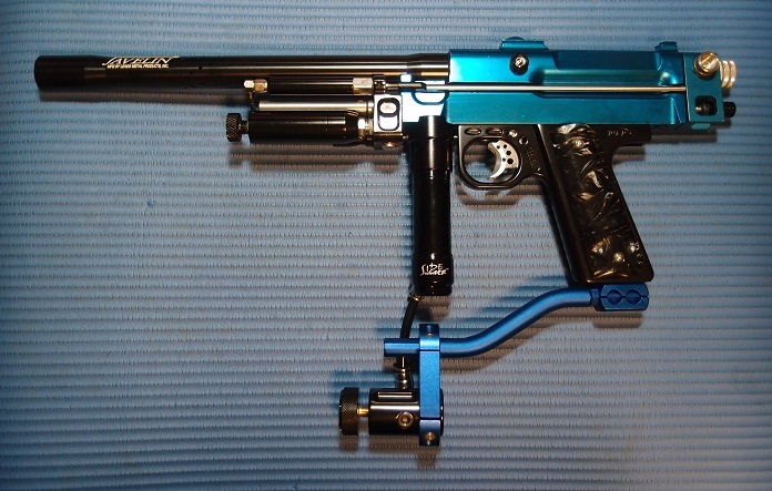

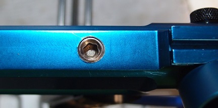

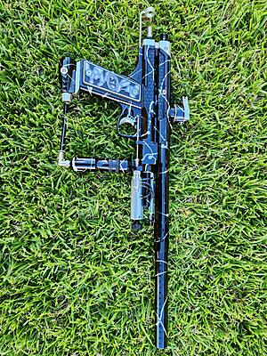

        John Gross Pre2k Autococker
        The sear lug access hole has been enlarged, and threaded for a plug. Once I got into it, I found that when the original hole was drilled it was a bit off. The hole was enlarged to allow access. Not the way I would have done it, but it works and the plug sits flush and does not impact the bolt. The slot in the bottom of the body, for the lug, was a bit narrow. A little polishing took care of the binding.
        The parts:
        - Bolt and pin: WGP
        - Lower tube: Shocktech, the IVG is non-threaded and came from ANS.
        - Cocking rod: AKA for now
        - Timing rod: Shocktech
        - Frame: Wgp
        - Trigger plate: Shocktech
        - Sear: WGP roller
        - Trigger shoe: Shocktech
        - Front block: Meteor with Shocktech pneumatics
        - HPR: AKA Sidewinder
        - Ball Detent: Shocktech, for now
        - Barrel: AKA Javelin
        It cycles fine and shoots to field speed....
